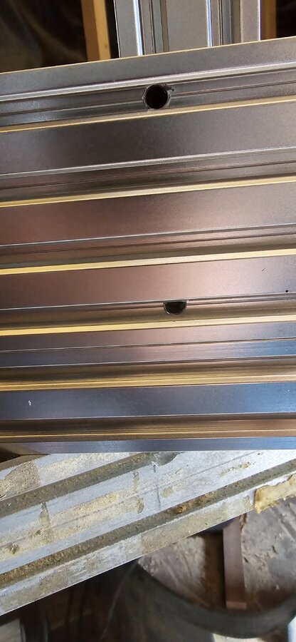

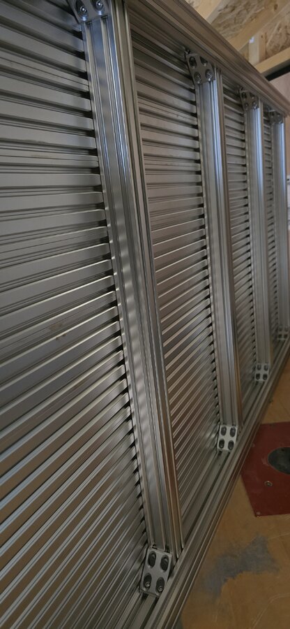

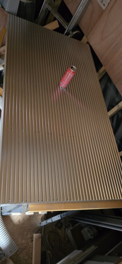

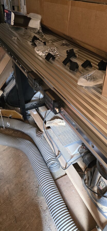

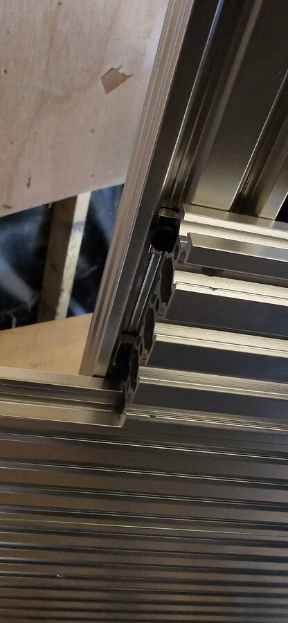

The bed is made up of 2 C-beams with 4040 stretchers. Then 8020 for the bed surface. The bed is attached from the top because I wanted the slats to be replaceable in case of oopsies and, once done, this machine will weigh a lot so I didn't fancy crawling underneath to replace slats or tighten bolts during maintenance, a lesson I learned from the original TFE.
The way they are secured can be seen here:
The underside of the bed is as follows:
And the top with a can of monster for scale:

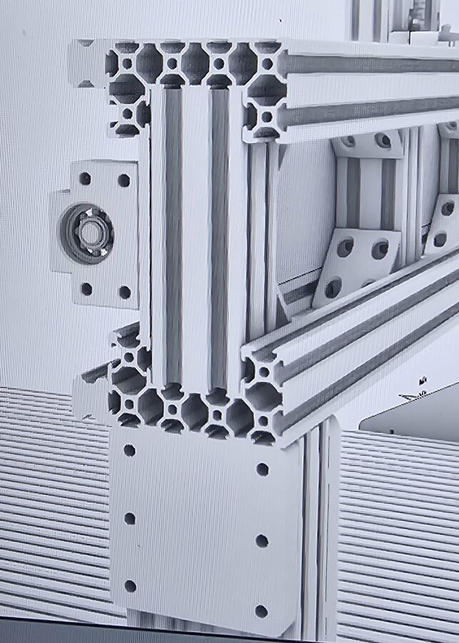

The X-axis will be constructed in a similar way to the bed, with 2 C-beams and 4040 supports in between:

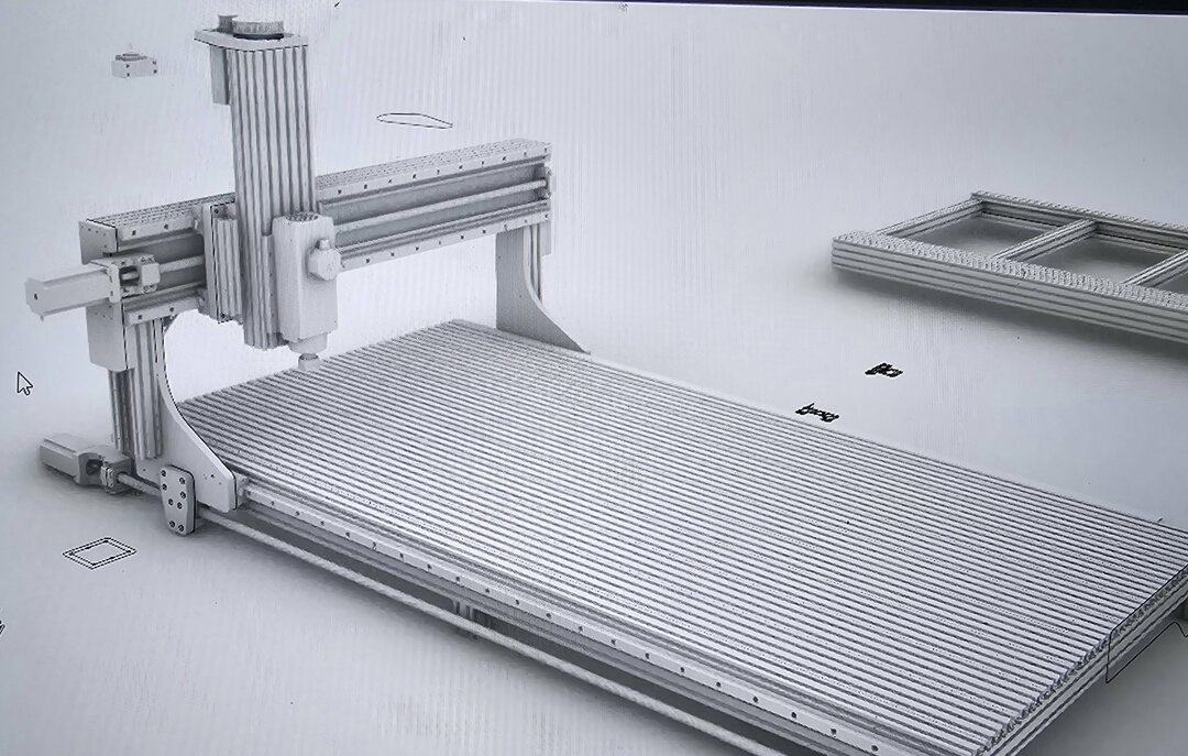

The machine when finished should hopefully resemble this: (But with extras like covers, drag chains ect.)
Important note about the Z-axis: I have gone with a belt coupled ballscrew since the Z-axis will be extremely heavy. I can easily achieve 1000mm/min with the original TFE using this setup, 20t on the stepper and 50t on the ballscrew. It's incredibly strong and 1000mm/min is more than enough for me.
The machining area will be roughly 1200x800mm with a Z of 140mm, which will allow me to later add a rotary axis.

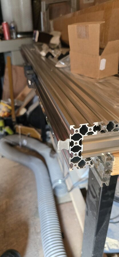

The frame with rails attached:

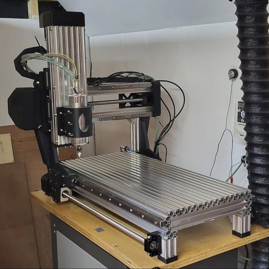

And a picture of the original TFE:
This is the machine that will be cutting all the plates for the new build. Despite all 3D printed plates, it chews through aluminium like a dream.
