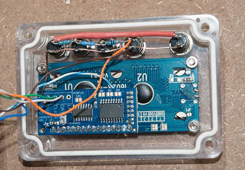

The eIectronics
I first reviewed the schematics that were used in the MiniE system and made some minor modifications to suit my needs, I incorporated the buttons that were previously included on the LCD shield as well as changed the connection to support the i2c LCD. Below is the revised schematic.
For the button array I essentially copied the schematic from the DFRobot LCD shield buttons, as below, using the same resistor values in the new array. This allowed for a for the same button values and no modification to the code.
The i2c LCD backpack was connected to the LCD screen as per this tutorial.
I found that the i2c backpack didn't allow for control of the LCD back light, changing the setting for the back light essentially either turned it on or off, without adjusting the brightness. I opted to remove the connection between the i2c backpack and the LCD and instead directly connect pin 15 on the LCD to D10 on the arduino as was originally assigned in the MiniE design. This restored the back light fading control.
Direct wiring to Pin15 on the LCD
The LCD and button array were installed into the lid of the box. The LCD is held in place with M3 screws and nylon spacers and M3 nuts.
The button array resistors were soldered directly to the buttons and the wires from the LCD and the Buttons to the Arduino were connected.
