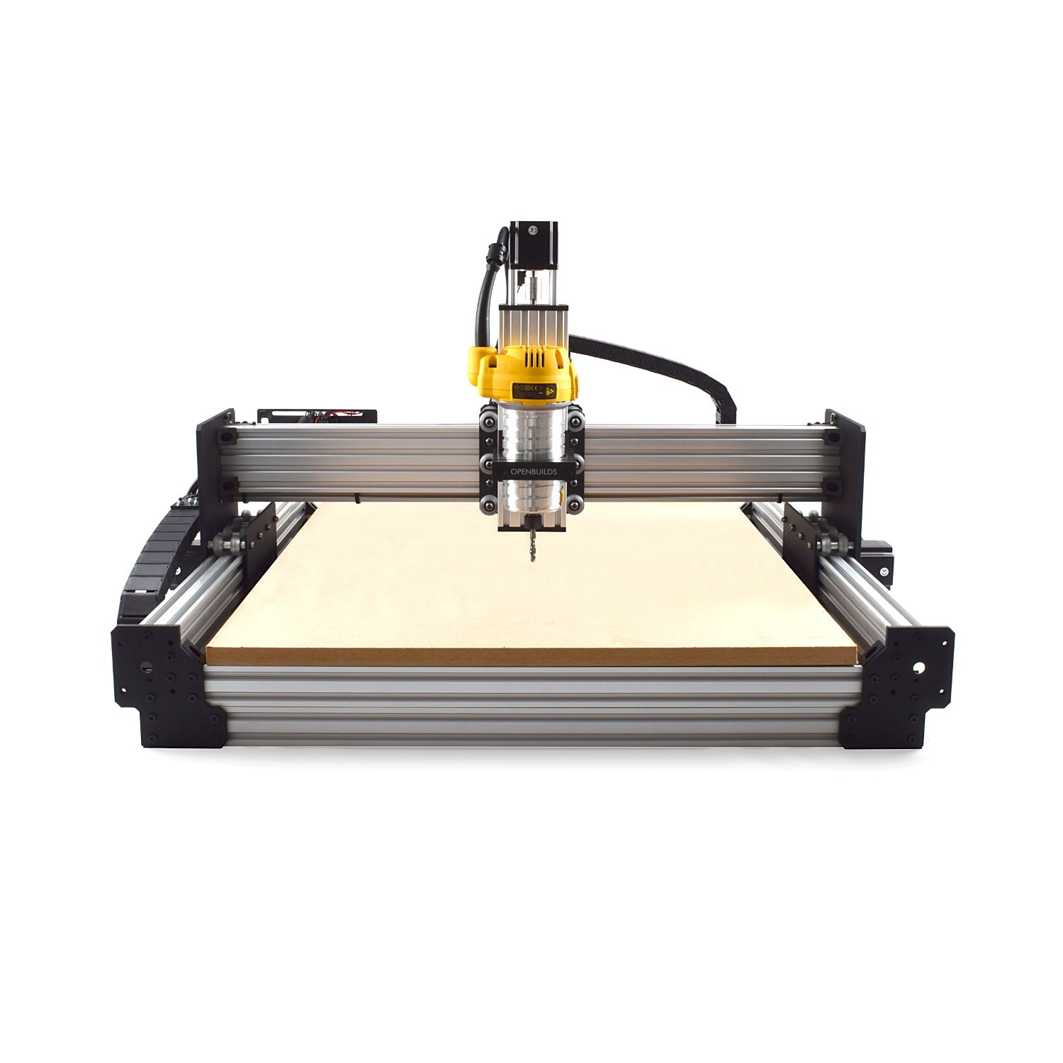

About The WorkBee
The WorkBee is our latest CNC Machine and is a culmination of all our experience, feedback, and suggestions from selling the OX CNC Machine over the past 2 years. The WorkBee is capable of accurately cutting foams, woods, plastics or aluminum at depths greater than 25mm to 0.2mm accuracy or greater.

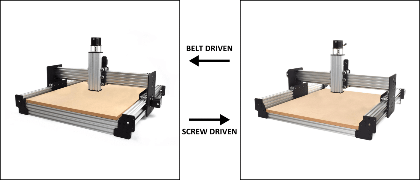

Dual Drive System
The main request we got for the OX was for a lead screw driven version. The WorkBee CNC Machine has been designed from the ground up to incorporate this and more. One issue with switching to a Screw driven system is that it would be limited in size to 1000x1000mm. This size limitation was not acceptable, so we have dual designed the WorkBee so it can be screw or belt driven. If the WorkBee CNC Kit is belt driven it can be made larger than 1000x1000mm. The WorkBee CNC Machine can be converted between the two, as the overall design is exactly the same for both.
