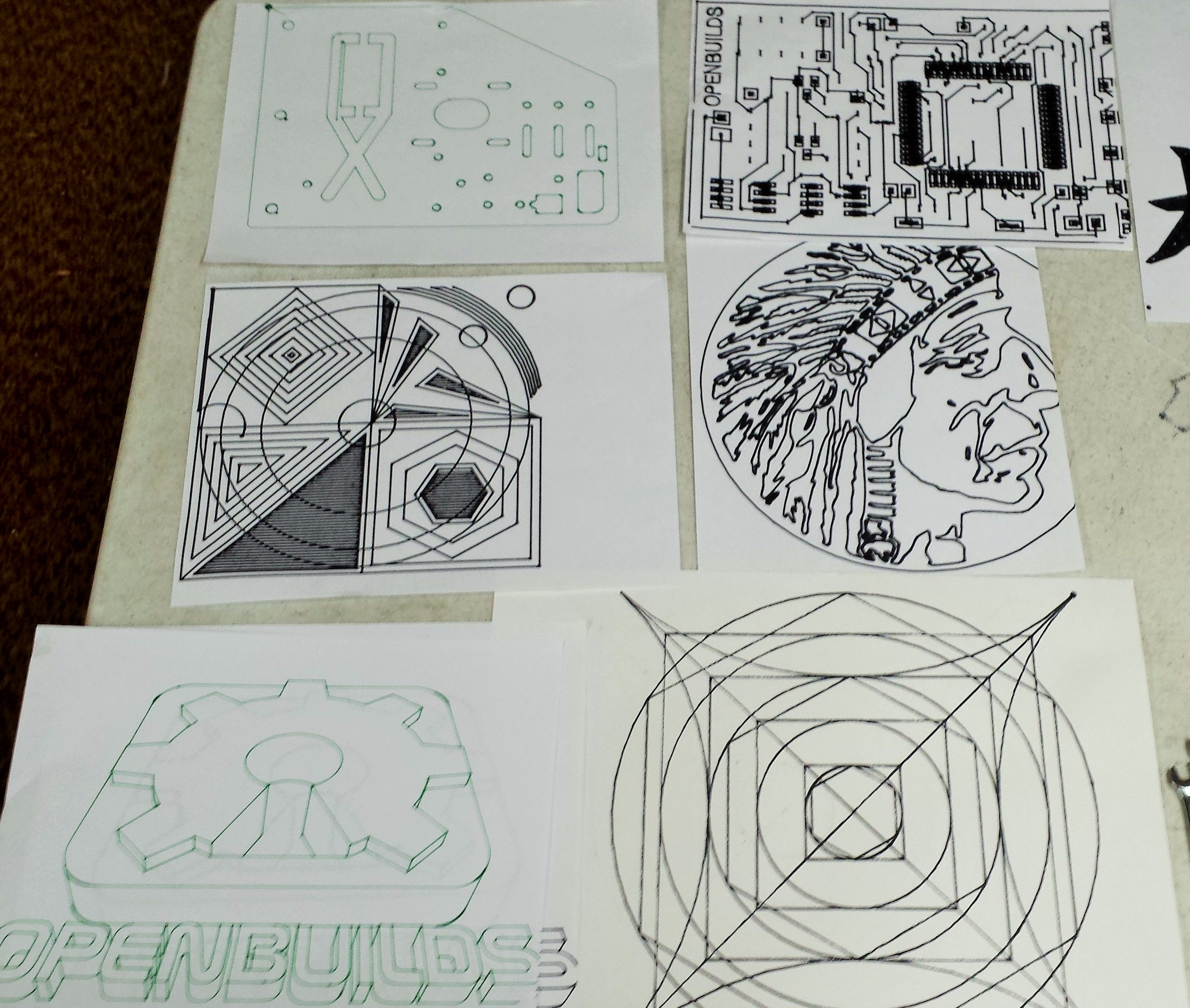

      lol, I was just running these through the new retract prevention code yesterday....
      and messing with the indian head using the EdgeTools2 'simplify' tool. set the tolerance to 0.125mm and it removes about 2500 lines. Gcode generates and cuts much faster.
    • Joe Santarsiero
      How was the bottom left generated? Middle left is a cool test. Top right...hmm...:)
    • Mark Carew
      Good eye @Joe Santarsiero ;) On that one I made a 3D model of the logo and then rotated it and exported the view as a DXF in that position.
      Its a pretty cool effect when done :) Top right is all looks at this point :)
