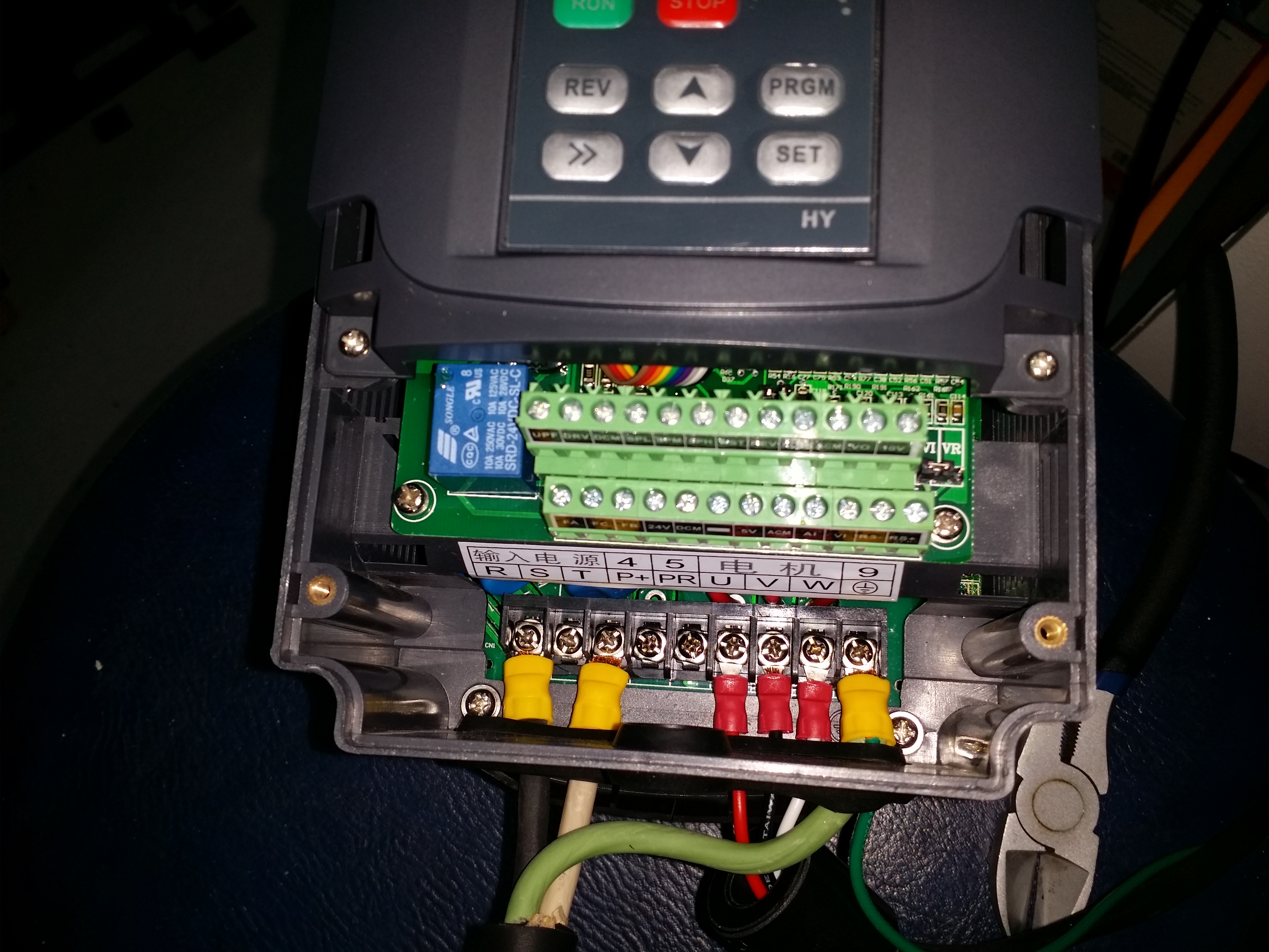

Chinese 2.2kW VFD Wiring
The 3-phase (UVW) wires are arbitrary from spindle to VFD. I also earth ground the spindle chassis to the earth ground of the inverter.
