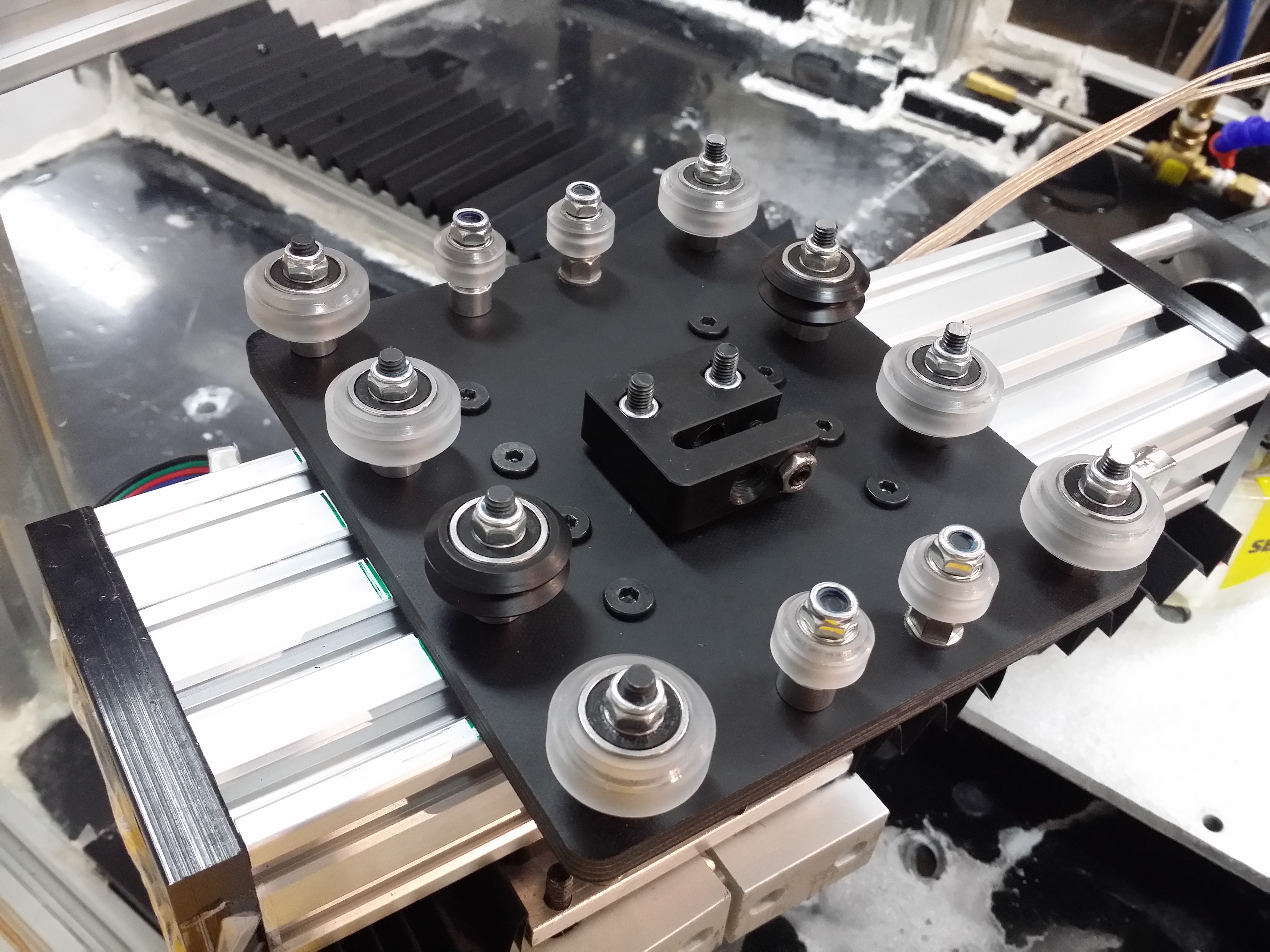

G10 X-Gantry plate with wheels attached
Adds significant amounts of rigidity to the machine in the X-axis. Removed much of the lateral deflection. 12 wheels total. Have since updated the model so all the mini-wheels are on eccentrics so the top and bottom large wheels can be tightened properly.
