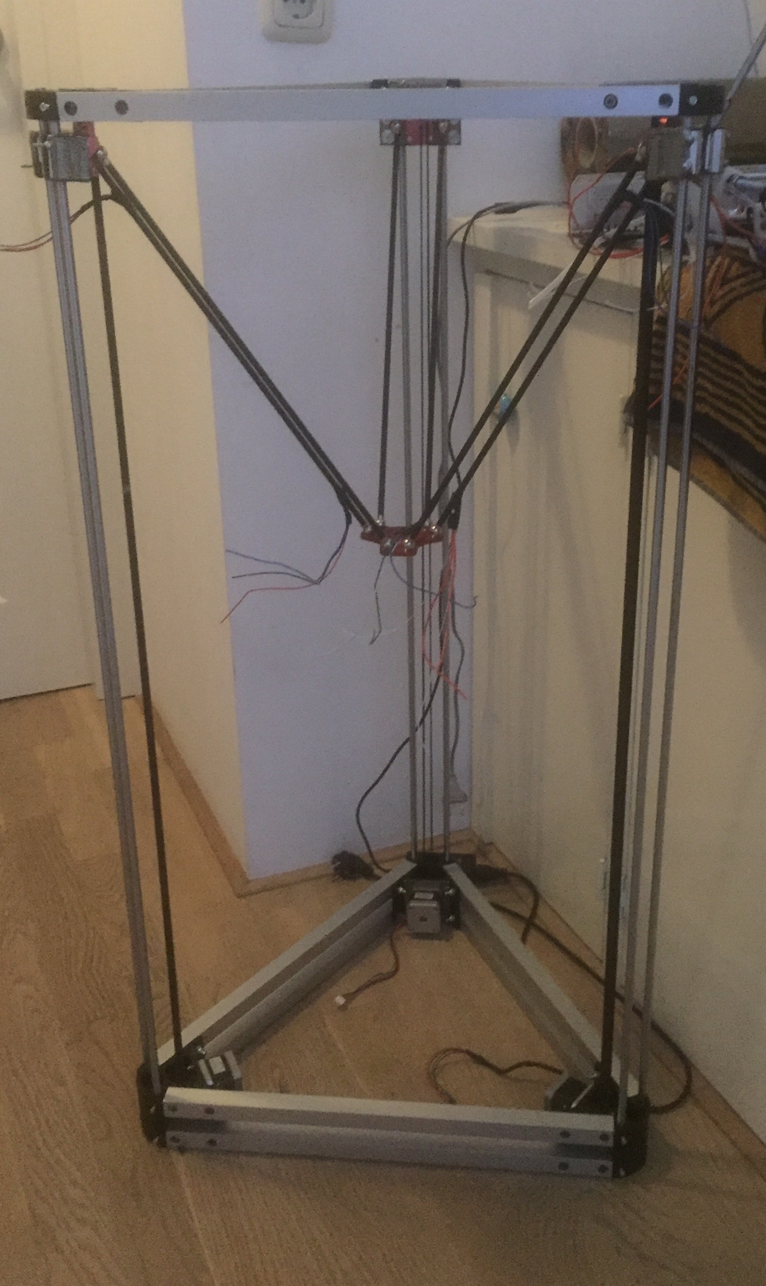

This photo shows the core frame assembly using 1000mm chromed rods, CNC Aluminium corner, 400mm Carbon rods with wires for the effector run through the cores and magnetic spherical connection to the effector (to allow easy hot-end swaps)
