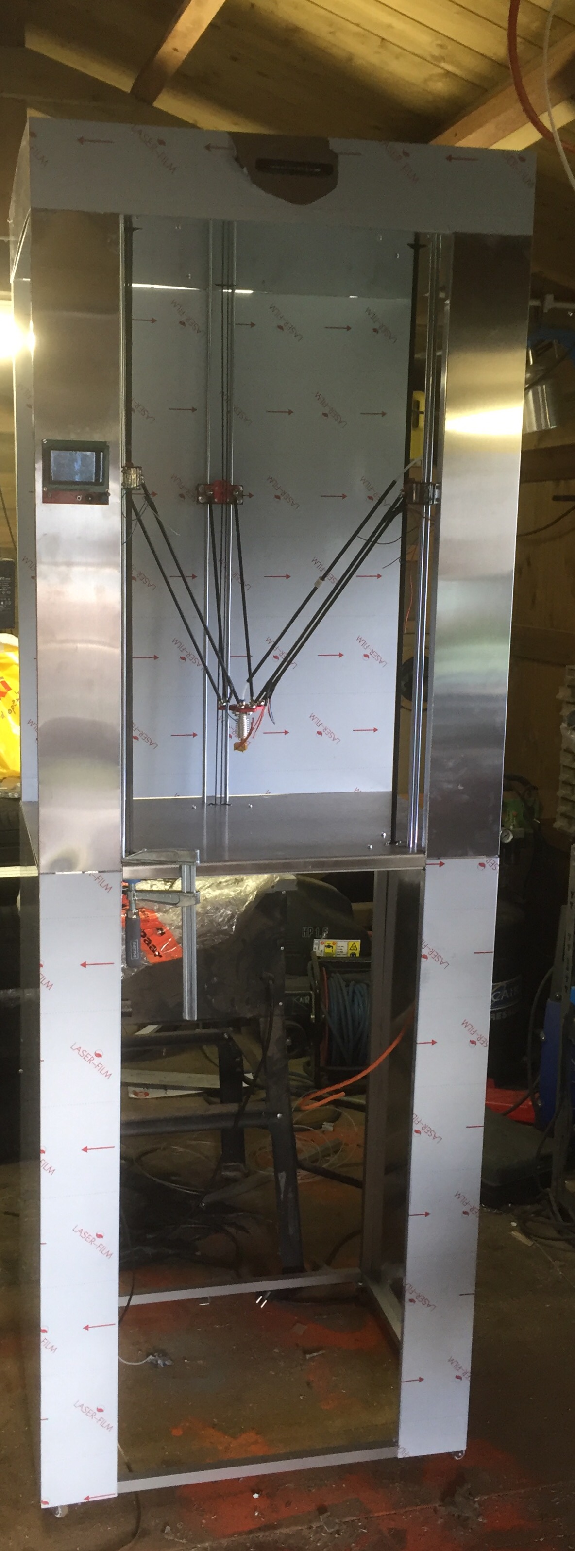

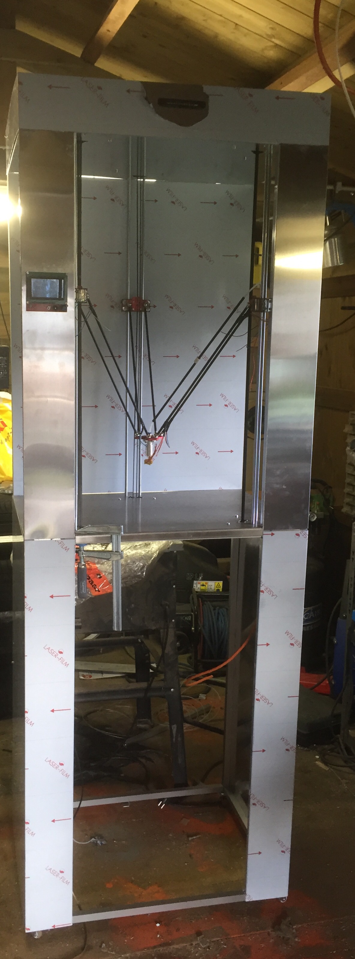

Trial fitting of the 1st display and the internal network indicator panel.
The printer farms houses it's own network switch with wifi and 4 ports. There will be a Raspberry PI with 7inch touch screen and AstroPrint plus a switch to use either Astroprint or an external computer for the connection to the RAMPS1.4. The RAMPS1.4 has it's LCD display trial-fitted on the left
