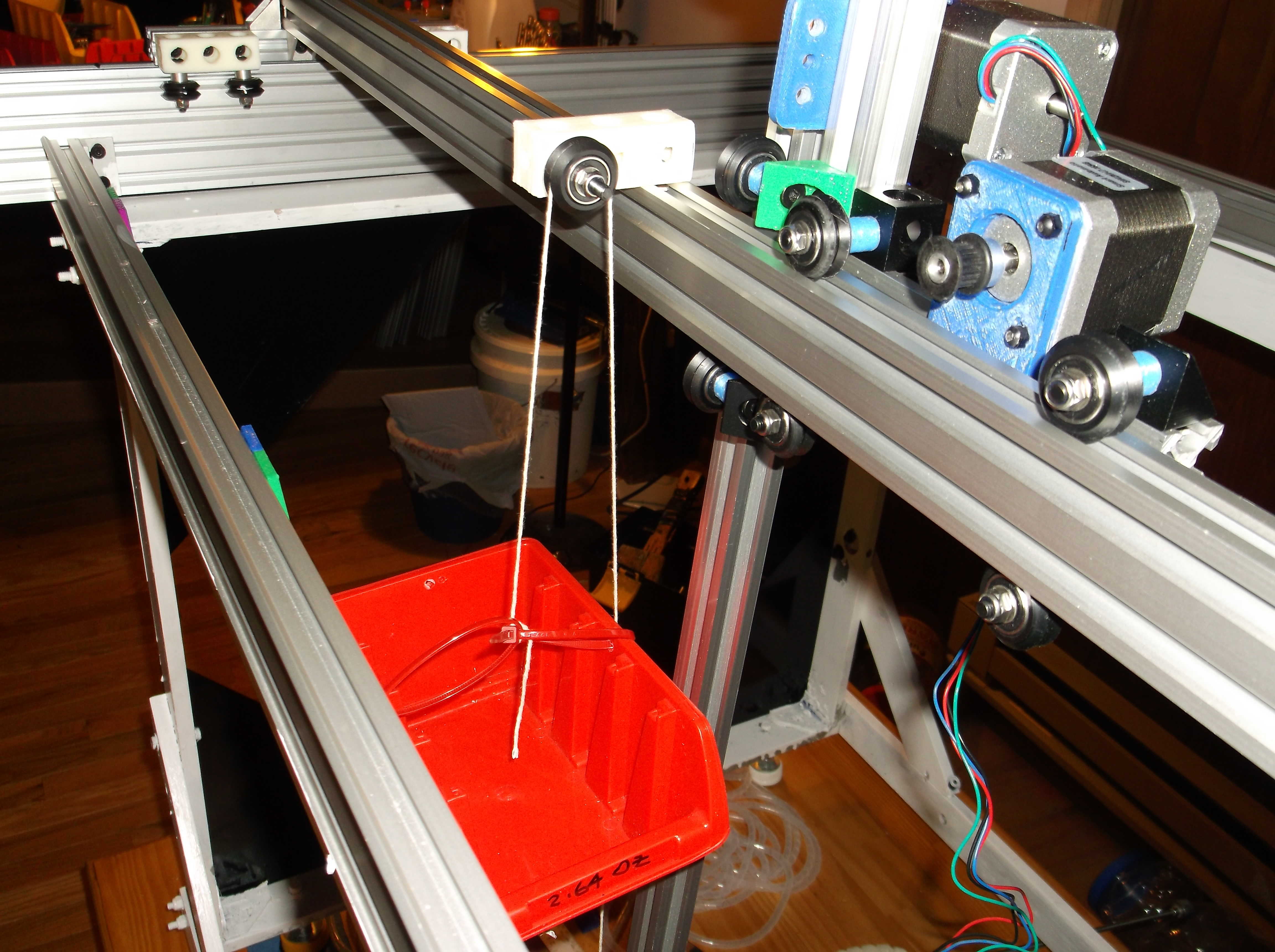

Z-axisStartingFriction
Measured the force required to overcome starting friction of the z-axis assembly. Note that no steppers are active yet. Need to know what force is required to start lifting z-axis extrusion. A weight of 40 oz (2.65 lb) in the red container started the z-axis rolling freely upward.
