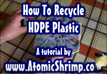

In a recent discussion here at OB we talked about making engineering wax (laced with LDPE) and the subject of recycling HDPE (bottles, caps, ...). So here is an Instructables by Atomic Shrimp which I'm thinking of following to work with HDPE.
How to recycle HDPE (milk bottles and caps) into usable sheet material - All
Right now, I am collecting HDPE - any 'plastic' with the marking /2\ and/or "HDPE". This is milk jugs, water bottle caps, shampoo bottles, etc. Avoid a container which was used to store dangerous products (bleach, etc.) Mix or sort the colours and have fun.

The first method only required a good pair of scissors and a sandwich press. It looks easy and quick to create thinner sheet stock.
