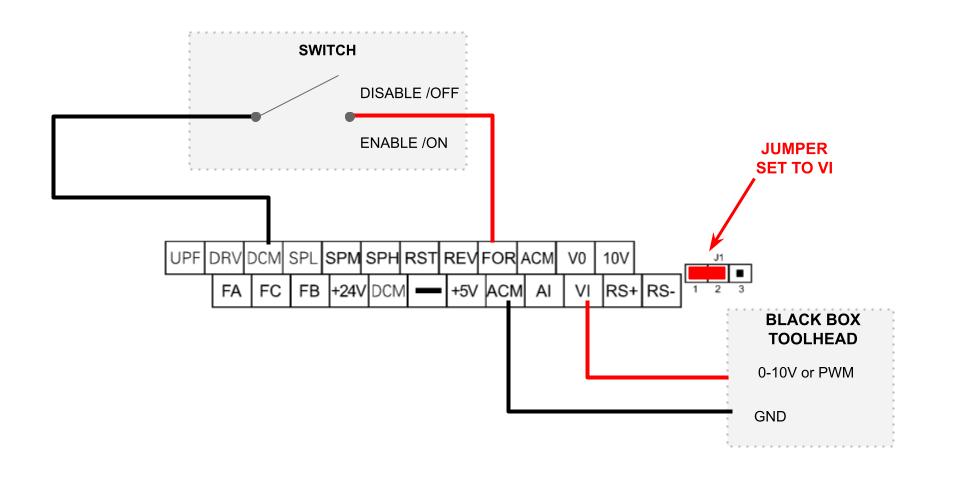

OPTION FOR 0-10 OR PWM SPEED CONTROL
This gives you control of the spindle from just a 0-10 volt signal. It seems like this is the option that most people use, and are happy with. For me there were a few things I did not like about this config, I will detail these things below.
Set all parameters from 'BASIC MOTOR SETTINGS'
You could use 0-10 or PWM to control the speed of the spindle just see the options described below. I found the PWM resulted in a slightly more accurate speed setting.
Connect the low voltage wiring as follows.
From the blackbox wire the toolhead GND to the ACM terminal on the VFD.
From the blackbox wire the toolhead 0-10 to the VI terminal on the VFD. OR you could use PWM to VI. I used a shielded cable for this, the drain is connected to ground on the VFD side.
You need to install a switch or jumper wire between the VFD terminals marked FOR and DCM. I feel it would be smart to connect a switch here rather than a jumper. Closing this connection tells the VFD to run at the speed given by the VI terminals, but not less that the min freq defined by PD011. This connection does lock the VFD in the run mode, keep this in mind. If you press the stop you will need to open and close this connection or power cycle to restart the spindle. Also, this connection needs to be open when making some programming changes.
You need to set the VI/VR onboard jumper on the VFD to the VI position.
You must make the following settings to GRBL. This will set up the 0-10/pwm outputs to scale the BlackBox output voltage over the desired speed range.
set $30= max spindle speed 24000
set $31= min spindle speed 0
VFD parameters
PD01 = 1 this uses external terminals (FOR) to set run command.
PD02 = 1 this set the operating frequency to the external source (0-10)
PD011 = 0 Frequency lower limit. With external control the VFD will not allow the spindle to operate below this limit, this parameter is a safeguard to keep you from operating the spindle a speed that might damage it. If you want the 0-10 volt signal to be able to stop the spindle this needs to be set at 0 and you should be aware that you can operate the spindle at a speed that might damage it.
PD044 = 2 this default, FOR input to run spindle
PD070 = 0 Analog input 0=0-10v OR if you prefer pwm 1= 0-5v (PWM)
The following two parameters correlate to the GRBL $30 & $31 these set the VFD to accept the 0-10 or PWM range that the BLACKBOX will output and set the spindle speed accordingly.
PD072 = 400 High Analog Frequency. 400hz = 24000rpm
PD073 = 0 Low Analog Frequency.

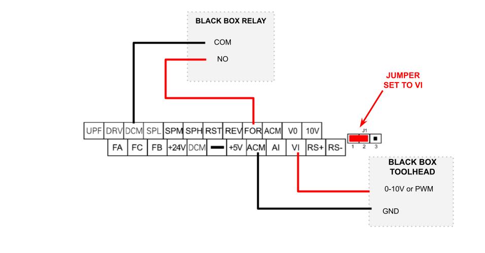

USING CUSTOM FIRMWARE AND THE 'USE_SPINDLE_DIR_AS_ENABLE_PIN'
This option is more work than the other options for sure. However, this gives you speed control over the spindle and allows you to set a min speed protecting the spindle from possible operator or g-code mistakes. This may also open up other options for you, such as setting the output relay on the VFD to turn on and off with the run command.
Connect and set up everything from '0-10 OR PWM SPEED CONTROL' with the following 4 changes.
- Connect the RELAY outputs COM and NO from the blackbox to the FOR and DCM on the VFD. Don't install the FOR-DCM jumper described in the section above.
- Set GRBL $31 to your min spindle speed. I used 9000rpms.
- Set PD011 = 150 this is your safeguard to not run the spindle below a min speed.
- Set PD073 = 150 to you min speed. I used 150 for 9000rpms.
Set the onboard relay jumper in the blackbox to DIR/VFD
