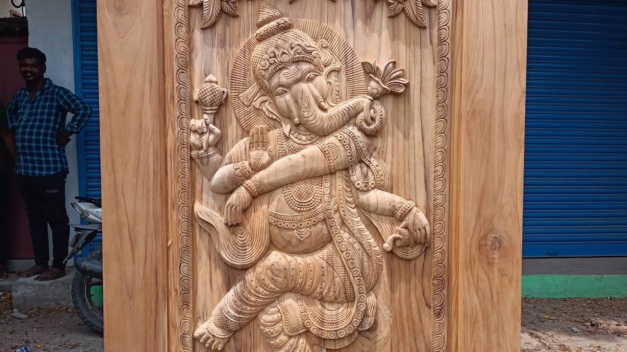

Intermediate San.svg
Rating:
5/5,
  • Machine Type:
    Other Machine
    Software:
    OpenBuilds CAM, OpenBuilds CONTROL
    Electronics:
    OpenBuilds BlackBox
    Machine Time:
    Approx. 60–90 minutes (depends on depth & feed rate)
    Bit or Laser Size:
    3 mm End Mill (Flat)
    Feeds & Speeds:
    Spindle: 18000 RPM
    Feed Rate: 1200 mm/min
    Plunge Rate: 300 mm/min
    Pass Depth: 2 mm
    Materials:
    MDF / Plywood / Wooden Veneer
    Thickness: 6–12 mm
