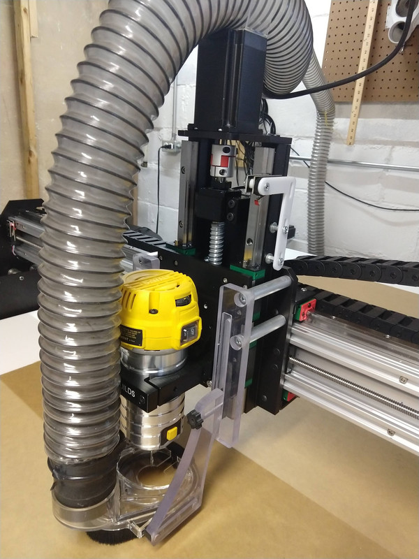

    I can't answer all your questions, but I can tell you about my Ox experience. First, if your 8mm lead screw is still long enough when you are done with the modification, it should be fine. I am in the process of converting my lead screw driven Ox to have linear rails. I use the McMaster Carr 1/2"-10 5 start screws on my Y but 3/8" 4 start on my X. I thought the modification would be a simple process, but the linear rails mounted on 20x80 v-slot profiles made it so the Y gantry plates had to be bumped out 1/4" due to the width of the linear rail blocks. This is why you see the modified workbees running the rail on the inner v slot. I did not realize this until after I purchased the linear rails. I now have to replace the lead screw - or lose cutting area - so I went with the OpenBuilds 8mm. It will fit nicely in the package that is coming to me with my new Cbeams.:thumbsup:
    My original plan was to cut new spacer plates out of 1/4" aluminum for the ends of the X axis beam. I did not want to loose any cutting area, hence the spacer. If I did not use a spacer, I would have had to disassemble the entire base to shrink the width as well. So, after spending hours designing it all and recognizing all sorts of complications I bought the LEAD High Z mod and extra pieces (cbeams etc...) to do a modified version of that. I have spent probably 20 hours modeling this, but I am glad I did because I found many holes that didn't line up which also happened to me on my first build. At least on this build I have a CNC machine to make my parts so I do not have to hand cut and drill everything like before.
    In a nutshell, I found that with an Ox design the linear rail mod leads to more mods due to the lack of being originally built with c beams. Here is what I am doing currently based on Jacobs design in this thread. There still needs to be a couple brackets added. Although the pictures show the X axis raised, I will run it in a lower position a majority of the time for increased Z rigidity. The whole X will be joined as one piece.

    I haven't actually cut anything yet... just got all this done, but I put my rails on the top & bottom. It's one of quite a few modifications I made. I like the rails this way because it keeps the head tucked back closer to the gantry. And I'm sure it helps stiffen the gantry,but I also doubled up the c-beam to further stiffen mine.

    Did you make or buy the dust shoe shown in the image in the above post?

    So did u put a C-Beam behind the one in the picture, I see some allen bolts above and below the lead screw?

    Yes - the c-beams are bolted through, and bonded with VHB tape. The rails are both on the front beam; the back on is there just to help with twist (and it does). Eventually i'll post my build on here.. right now i'm trying to get caught up on jobs I've gotten behind on while I set this new machine up.

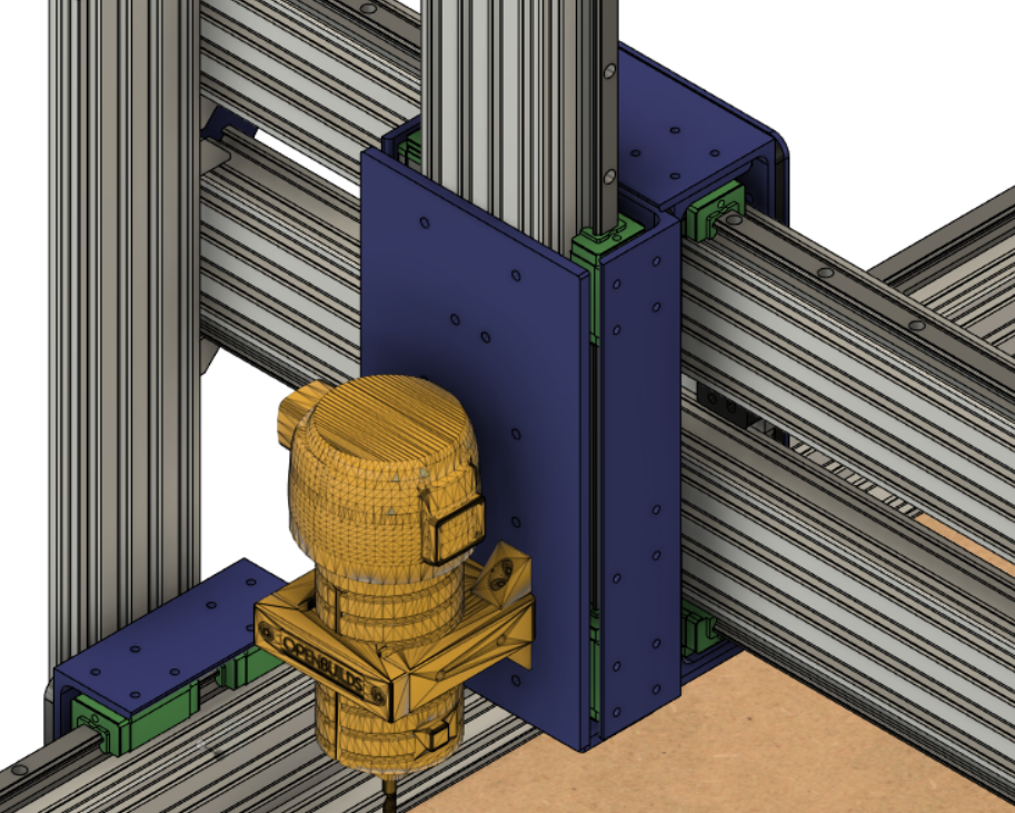

    azrael_sk New
    May 13, 2015
    Made them out of 5mm (x and y) and 10mm (z) thick aluminum L profiles. You can download drawings and fusion models from here: Workbee on rails documentation
    Rails used are hgr15 and hgh15ca blocks/sliders.

    You could take the file for the bearing blocks to a machine shop and have them do it. The file is posted in the "files" section.
