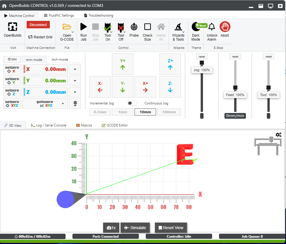

    Hi,
    I have an issue with the 3d View. Actually its only topview.
    What I've done so far:
    - Read the forum
    - Updated all Graphic card related drivers to latest versions
    - Updated monitor drivers to latest versions
    Hardware used:
    - Surface PRO 7
    - i7 CPU
    - 16 G Ram
    - Intel Iris Plus Graphics
    - DirectX12
    - Intel drver 31.0.101.2121 (latest)
    - OpenCL Runtime 3.0
    - Vulkan 1.3.215
    Question:
    - Do I need to do some special definition of the Machine to access 3d view in 3d, not 2d?
    Thank you for your help, suggestions.
    Joé Braas

    1) in which software?
    2) screenshot may help
    3) in most applications you rotate the view with mouse, some left button, some right button, some middle button.
  3. Joé Braas
    May 23, 2023
    Hi Peter,
    Software: OpenBuilds Control v1.0.369
    I can try whatever I want on the coordinate view, move mouse, all buttons, even 3dconnection mouse... the view will not rotate in the 3rd axis.
    No 3d service disabled:

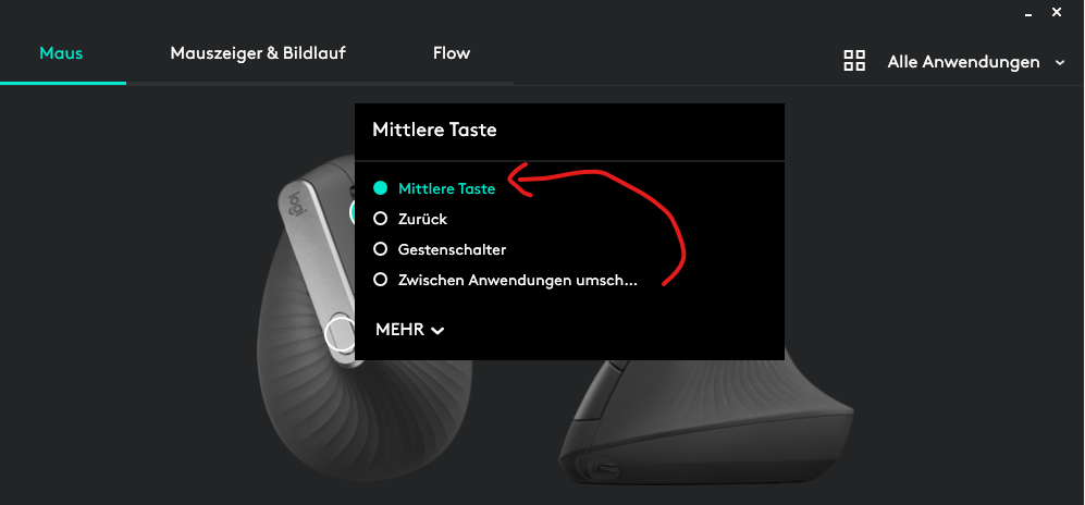

  5. Joé Braas
    May 23, 2023
    Ok, I got it.....
    The middle mouse button is the thing!!!!
    - A touchpad doesn't have a middle button, and my mouse, since the middle one was never used is configured to: 'toggle between apps.'
    The middle button is necessary... now i'll try to configure the 3dconnection mouse.
    Thank you Peter for the right hint.
