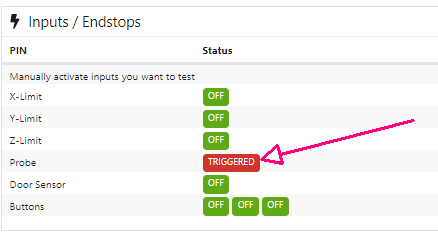

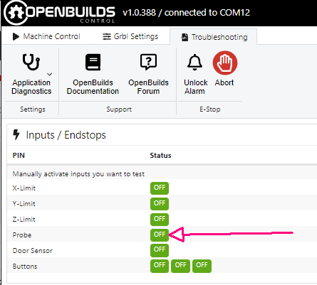

    maybe.

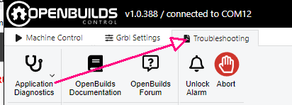

    in OB CONTROL on the Troubleshooting tab
    when the probe is NOT active, the magnetic tag is NOT touching the body of the probe, you see this
    upload_2025-5-2_12-29-18.png probe is GREEN/OFF
    then, when you touch the magnet to the body (same as if the magnet is on the tool and the tool touches the body)
    you see this RED box labelled TRIGGERED
    upload_2025-5-2_12-30-29.png probe is triggered.
    So, you need to set the probe input invert to whatever gets you this situation.
    and, if that test works ok with no other messages in the serial console, then the wiring is probably ok, but there are 2 tests to do,
    1. one with just the probe body and the magnet end touch/notouch, and
    2. another test with the magnet on the tool and you being the body to touch the tool.
    If those both work ok then the wiring is probably fine.
