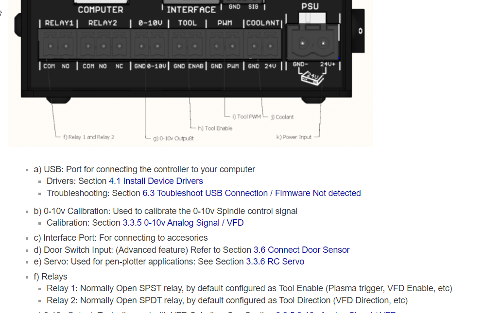

    How much voltage/current can the relay in the blackbox handle?
  2. Gary Caruso
    May 19, 2016
    1,193
    532
    • Up to 24v 5A Switched Output for Coolant or LED devices
    from the spec list
    Cheers
    Gary
  3. Peter Van Der Walt
    15,050
    4,313
    That's the coolant output's spec docs:blackbox-x32:connect-coolant [OpenBuilds Documentation]
    Relay is something else. Max 6A (for BlackBox 4X per title of thread) , dry contact but keep to DC please

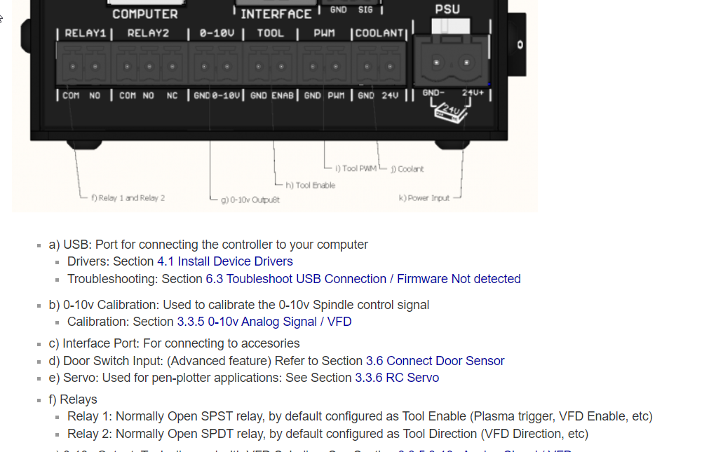

  4. Gary Caruso
    May 19, 2016
    1,193
    532
  5. Peter Van Der Walt
    15,050
    4,313
    Not really rated, but documented for specific use cases. X32 is <3A (smaller than 4X to fit extra relay)
    Ps OP was asking about the 4Xs relay, the above is an X32 - different specs - see thread title
