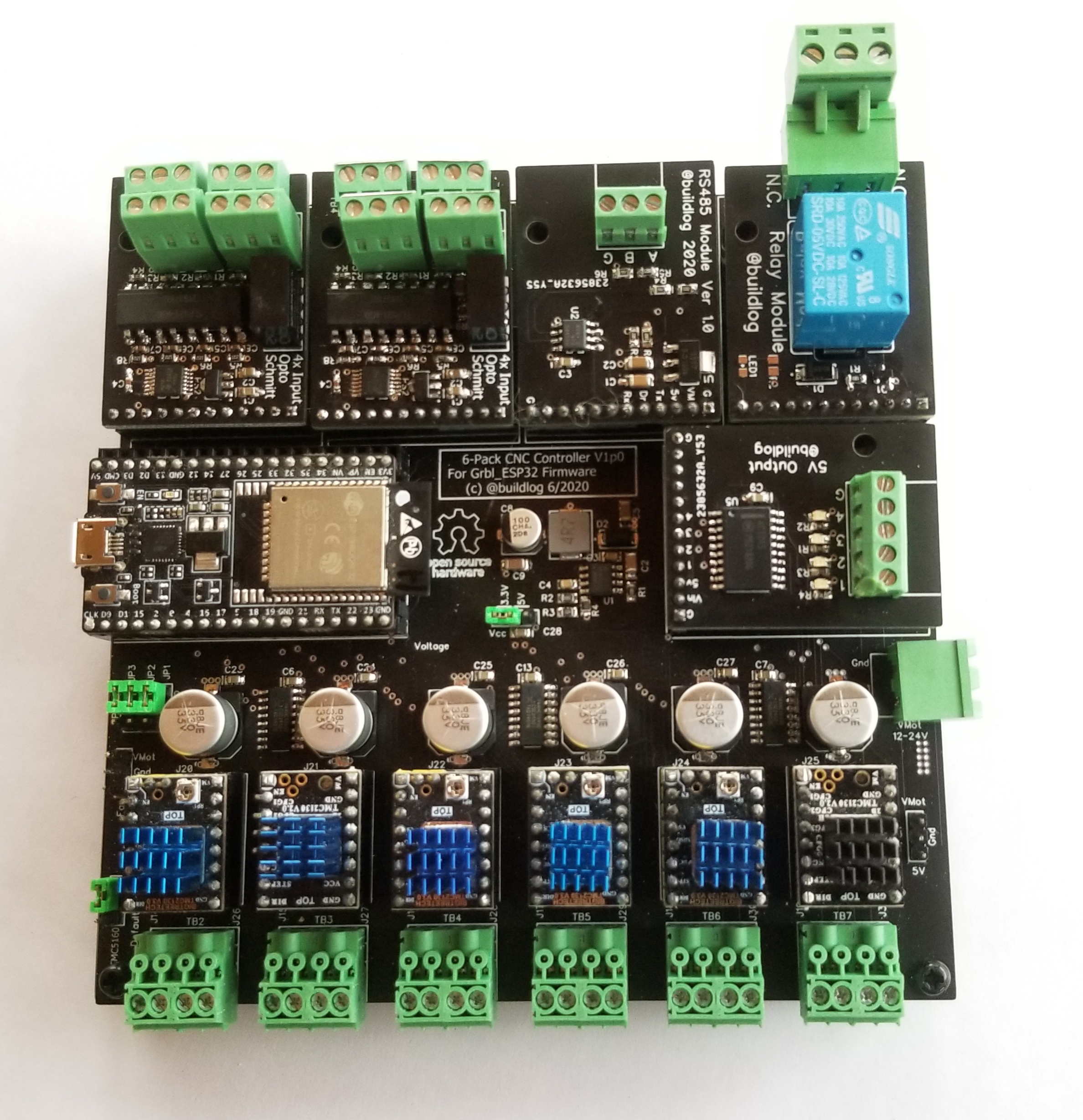

    Can be bought here (6 Pack Universal CNC Controller by Bart Dring on Tindie), but I am posting the link for the details there (I have no connection, and it is not an affiliate link as far as I know).
    It is modular and based on the ESP32. I'm considering this over the prebuilt controllers because it supports various drivers, and specifically for me, the TMC5160 Trinamic drivers. IO modules, pwm, relay, bunch of others, all open source so you can design your own stuff. Also has a built in SD, and the esp32 has wifi and bt.
    The guys github page has all of the board specs, so you could build your own if you want.
    Since it is also based on the ESP32_GRBL firmware.. it would not be a stretch to implement the openbuilds control software to work with it... the last part is optional, CNCJs would work with it just as easily.
    Total cost for the lead would approach the same cost as the Xpro v5 due in Dec, or the Blackbox, but it is reasonably future proof, as you can replace the modules, upgrade the ESP module or IO modules as your needs grow.... If you skip the expensive TMC driver (go with the 2208 or 2209 instead of the 5160) you could drop the price to sub $100, but the 5160s are about $20 a piece, vs $5 to $8 a piece of the others.
    I'm particularly interested in the 5160 (although I believe the 2208/2209 have it as well), that will do sensorless homing (no limit switches I think), and auto squaring.... As well as being able to drive significantly larger steppers as I think the 5160 supports up to 20A !!! (this assumes whomever makes the pololu style modules includes the correct circuitry, so far the ones I came across supports 3 to 5A)

    The specs say that it will support a MOSFET capable of 20A and these MOSFET are quite big. Probably will never work on a Pololu type driver but still, 4.2A that they can deliver now is quite respectable and in line with most high end drivers.
  4. David the swarfer
    3,604
    1,978
    all ok except for those tiny stepper drivers, they are great for 3D printers, not great for routers since you need 2.5 to 3 amps and they cannot do it.
    however, you CAN use those sockets to interface to external DQ542 or similar drivers.
    Rick 2.0 likes this.
  5. JustinTime
    JustinTime Veteran
    Dec 18, 2013
    784
    260
    Actually the TMC5160 are rated 4.2A. I'm sure you'll have to have a fan blowing on them but I have it anyway on my 3d printer.

    I looked at the datasheet and it only claims 20A with external mosfets. Where does it say 4.2A? Also, those sockets don't look particularly special to me - I'd be surprised if they supported that much current. Pin headers start to glow at about 3A.
  9. ljvb
    ljvb Well-Known
    Feb 14, 2019
    276
    87
    The pololu modules that Bigtree and a few others have made using the TMC chips seem limited to 4.2a based on their designs.
  10. phil from seattle
    phil from seattle Journeyman
    Mar 17, 2017
    315
    139
    OK, well that answers it. Those Chinese products are guilty of wishful specs. Look at the TB6600 drivers that are all over amazon/ebay/ali-whatever. Supposedly 4.5A but don't even use the Toshiba TB6600 chip and the one they do use is only good for 3.0 Amp. I did a tear down on one here.
    The issue is heat production and the Step Stick format simply doesn't have enough surface area to handle more than a couple of Watts of dissipation. Those little heat sinks they ship with them are simply not going to do it. Even with forced air. There is a reason why drivers like the DM542 have a heat sink bigger than an arduino mega.

    I don't think there is anything stopping us from using a bigger board and custom heatsink... with a ribbon cable or other wiring connecting the the module slot on the 6pack.how hard would it be to take the bigtree one and just spec up a larger board with bigger mosfets and heatsinks to take advantage of the higher current rating and bigger steppers.. That or build an external driver based on the TMC chip similar to the 6600 or DM542.
    The thing that attracts me to this board, is that the TMC chips, even running at a lower current, which for me is more than enough right now as I only have the high torque nema 23s that came as part of the lead 1010 kit, is the feature set, which no other chip can even come close to in the hobby price range.
    I wonder how hard it would be to design an external TMC5160 based driver.. as far as I can tell as I could not find any, there are no external drivers based on it at the moment...

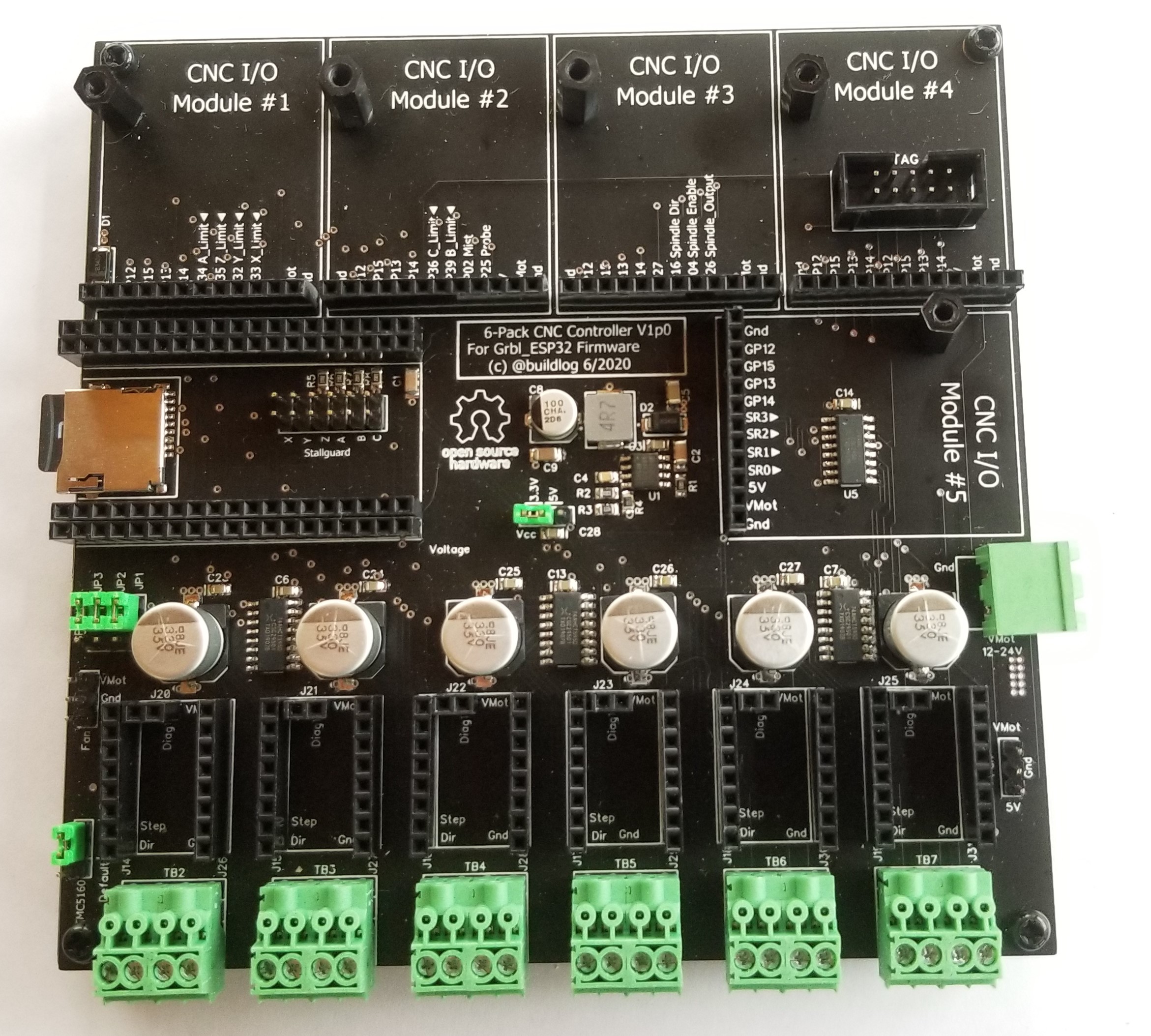

    I'm not sure I'm getting it. The pluggable modules are a nice theory, but none of them really seem super optional for basic functionality, and are quite expensive addons, so why introduce the failure point at all? Conversely, the driver headers definitely should be modular so stepsticks are a choice- either a stepstick board or just a straight step/dir terminal board. 0.1" pin headers are awful to interface with for external drivers. It just seems like the worst of all worlds in a fairly messy package.
    The "linearized" driver supply rail (at least, that's what I'm assuming from all the caps) is an interesting theory, though it'd arguably be better as a standalone external component.
    I dunno. The germ of the idea is interesting, but I'd like to see it heavily terminalized, the optos and buffers built right in, and the size of the thing probably cut in at least half- too much BOM and board space on optional things, not enough on what should be mandatory things. To be this "pluggable", there's almost no reason to buy it at all, it barely accomplishes anything more than some stripboard and a handful of header strips. It could be a really beefy interface for the ESP32 board, which is really all that's required.
    A term-to-term stepstick board could be interesting as a modular addon. Shame terminal plugs don't come inverted (that I'd seen) where the through-hole leg is on the plug, and the socket is screw terminal'd.
    [EDIT: Decided to Google "inverted terminal plugs" on a whim anyway... They totally exist. That's the way I would go. Board-to-board stepstick breakout, or straight wiring to externals]
    There are TMC5160 BOBs for $20 at the usual places- easy to add terminals, heatsinks and cases to. No need to reinvent the wheel, at least at that stage of the design process.

    Continuing my earlier point, the problem with the step stick format is that it just doesn't go much beyond 1A. It's physics... Those old TB6600 drivers (ones based on the real through hole chip) had adequate contact area to extract multiple watts of heat to a heat sink and thus cool the chip. And a design that allows tightly clamping the package to the heat sink. The surface mounted chips used on stepsticks just don't have a big enough of channel to extract the heat to a radiator heat sink. You can push the boundaries with forced air cooling but the bottleneck is the chip package.
    As to the "motherboard" approach, it's got some appeal but I agree that pin and socket adds failure risk. Or perhaps I should call it reliability risk. Plus, it isn't cost competitive versus a product that has the needed components on the base board. Perhaps the idea is that there are so many competing requirements that there would have to be a lot of different designs. One of the reasons I only make a 5 Axis BoB rather than 3, 4 and 5 Axis versions is that the incremental cost of an extra axis is minimal.

    I agree with your overall point, I'm not a huge stepstick fan either except where portability would be paramount, but I'd probably quibble a little on this one- LGA isn't much different to SMD in terms of physical board relationship, and you can extract tens of watts from an LGA device. It's all about whether the chip is properly designed for heat extraction and whether the board is engineered to do so (and some surface area considerations). Typically you get more heat out of the base of an IC than the top casing, so heavy isolated copper pours leading to heat pipes are the way to go (in *addition* to top cooling... LGA processors still have those!). There's limited space (maybe budget too) to do that kind of thing in a stepstick, where the larger format of an external driver allows for a reasonable spacing around the driver IC to get heat out both above and below. So you can totally use an SMD driver, but it has to be designed like an SMD project, not shoehorned into a through-hole project like the "TB6600"s.
    More accurate, yeah. I'd like to see more positive connection options as plug choices, either way.
    I thought about this but it doesn't seem to pass even a cursory consideration- machine tools have 3-5 axes, material manipulator robots have 3-6 axes, camera motion rigs have 3-6 axes... There's really no reason to include at least 3 axes' worth of components by default- it's cheaper and likely covers 70-95% of use cases- the BlackBox, essentially, but with more options. Axes 4-6 should be a single board option too- there are likely just as many people making 6-axis robots as are adding rotary axes to 3-axis routers.
    I think that makes sense. It's designed for machine tools, just throw it all in for negligible BOM cost and save on volume.

    Well, maybe but look at the TB6600 package - It's got mounting slots on either side that allow clamping to a heat sink. Whereas any SMD chip is is reliant on the PCB being pulled tightly against the heat sink. That places limits on how much pressure can be safely applied without bending the FR4 and a bit trickier to get the surface coplanar/flat against the heatsink. Also the TB6600 package has about 6X the surface area of the stepstick class of stepper driver chips. Unfortunately, Toshiba doesn't publish thermal resistance specs so a proper comparison is difficult to do.
    Yup. At least put 3 Axes on the base board. Perhaps that upsets the symmetry of it all or makes the true cost more apparent?

    You didn't add any IO modules, which means all of your IO is unprotected and on header pins instead of terminal blocks. Which is A) a fairly terrible idea (I bet pretty much everyone on this forum has destroyed multiple Arduinos at this point) and B) is not an apples-to-apples comparison to the BlackBox, which includes IO protection and terminals. At $20 a pop for those opto/buffer boards, and needing at least one, probably two, that's not looking quite so inexpensive any more.
    If you really think it works for you at a price you like, no one here's going to disagree. Hell, I use Mesa cards and I've destroyed two of those at $100 a pop. Hardware dies or is the wrong thing sometimes, it's all part of the learning process. But I wouldn't be so quick to dismiss the institutional knowledge that's built up here either. There's a reason we bring up these concerns (even if we do sometimes find a semi-related rabbit hole to dig down).
    The scalability was one of the parts I liked about it. But given that without 3 axes of motion control, basic limit/probing/spindle control/coolant ports, and an actual processor to run the code, it's not actually a solution in itself and builds unnecessary costs (BOM, pick'n'place setups, multiples of masks, etc- parts of the board manufacturing process that do not scale well at all) that get passed along to the user. So, designed properly with users in mind and not either some arbitrary sense of "freedom" or the number of items in a shopfront, 3 axis should be a baseline, not a target. Phil also designs 32-bit hobby CNC hardware, so I'm guessing he knows the exact process quite well.
    Scaling from 3 to 4-6 axes is a great option. Scaling from 0 to 3 axes and from "no IO" to "basic IO" isn't really a feature at all, it's an irritation. If I only needed one axis I'd get an Arduino and a driver and that's it (that's how my camera slider worked).
    That would be good, I'm guessing (because if I needed this type of solution, I'd go grblHAL on Teensy 4.1, but I don't so I don't have a horse in this race) the ESP32 could handle it. USB issues are the worst.
    No one's talking about building in the drivers. In fact, I semi-regularly criticize it on the BlackBox. :p We're talking about stepstick driver chips vs external box driver chips and the physical parameters/limitations of each within the confines of their operating locations.
    Fact is, stepsticks just generally struggle to dissipate heat above an amp or two, whether they're rated for 4A or not. That's not great for running NEMA 23s. Neither is being limited to only 24V in my book, but that's a trait it shares with the BlackBox so that's apples-to-apples for purchasing.
