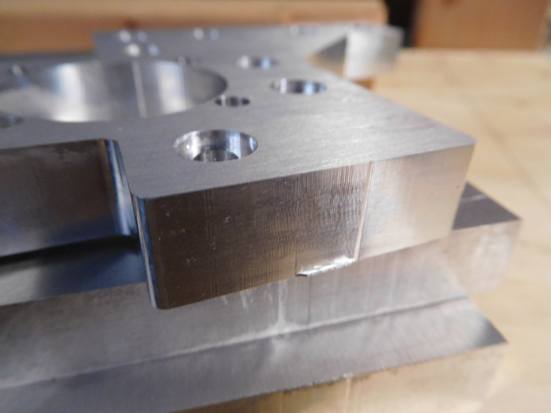

    Currently testing my new DIY fogless coolant setup. 1/2" 6061 / 4.5mm 2FL carbide. Working on dialing in Feeds & Speeds. DSCN1782.JPG DSCN1780.JPG DSCN1781.JPG

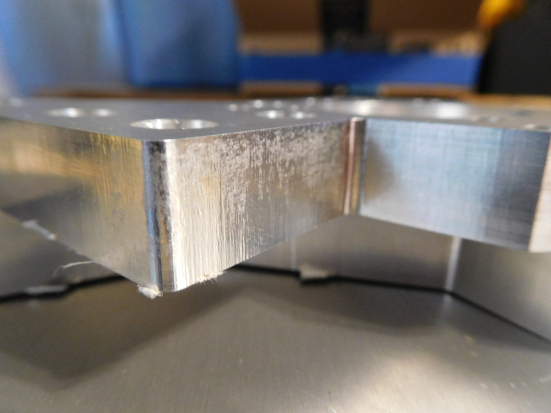

    So the first test went ok with the new water based coolant system. Side finish is still not perfect but better than before. I can see I am still re-cutting my chips and leaving small marks on the side. I believe I need a nozzle on both sides of the spindle. I'm still not able to take more than .3 - .4mm DOC without some chatter but a lot of this is dialing in feeds and speeds. Before this cooling system, I would have absolutely terrible side finish about 1/3 from the bottom but again, chip evacuation is critical for a nice clean surface finish. This piece was done with no final finishing pass, just standard contour operation. DSCN1787.JPG DSCN1784.JPG DSCN1785.JPG

    Actually I can hear the endmill grinding the chips left in the cut from the previous pass. The machine would probably be 1/2 as loud if I could clear all of them.

    Hey Michael - I concur with you on needing dual nozzles for blowing chips. I haven't incorporated a second nozzle yet, but I completely see that it would be very helpful in chip evacuation.
    Side finish on that part looks great considering no finishing pass.

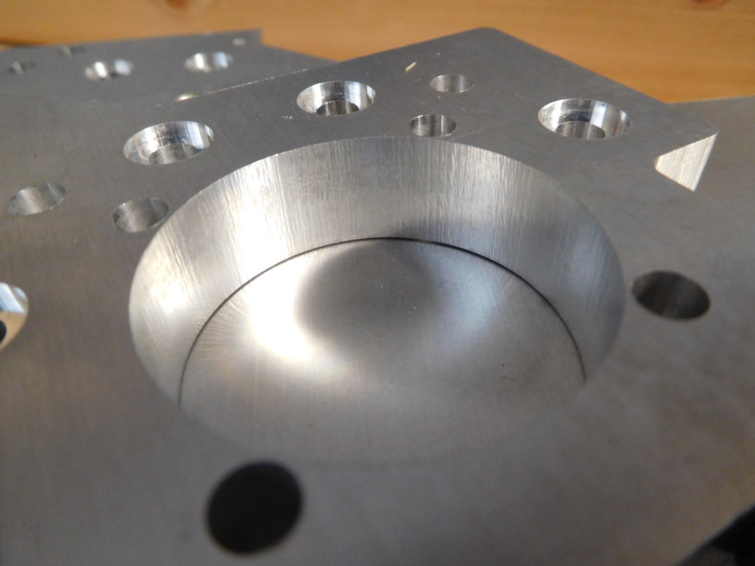

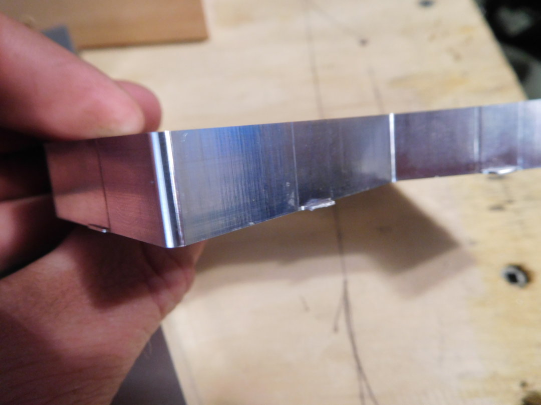

    Thanks buddy. Here's some more pictures. These are the ballscrew parts I am finally getting around to. You can see in the first picture the finish is great except for a weird bump where the machine lifts up to create a work holding tab (I must have some backlash or tool deflection). That first picture you commented on was an "L" shaped piece that allowed me to perform almost perfect two sided machining. The last picture is of the side that the air doesn't reach. This is 1/2" material but when I run 1/4", the air can reach a lot more. DSCN1826.JPG DSCN1829.JPG DSCN1824.JPG DSCN1828.JPG

    Originally I only used my mist nozzle with air and just didn't hook up the coolant but recently I built the first version of a coolant system that uses water soluble coolant. It's still not perfect. I'm trying to make a fogless system because the cheaper mist type nozzles will fill the room with a coolant fog which isn't healthy.

    Those marks are common with tabs for some reason. Parts look very good, I'll have to send you some pics of things I've been working on.
