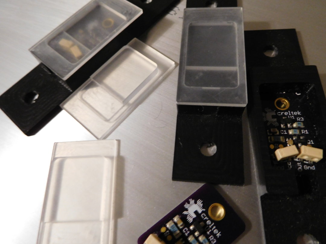

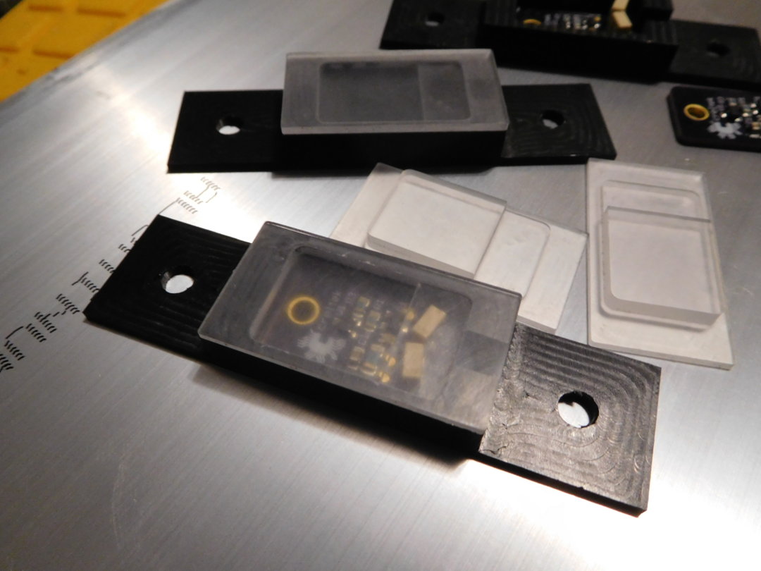

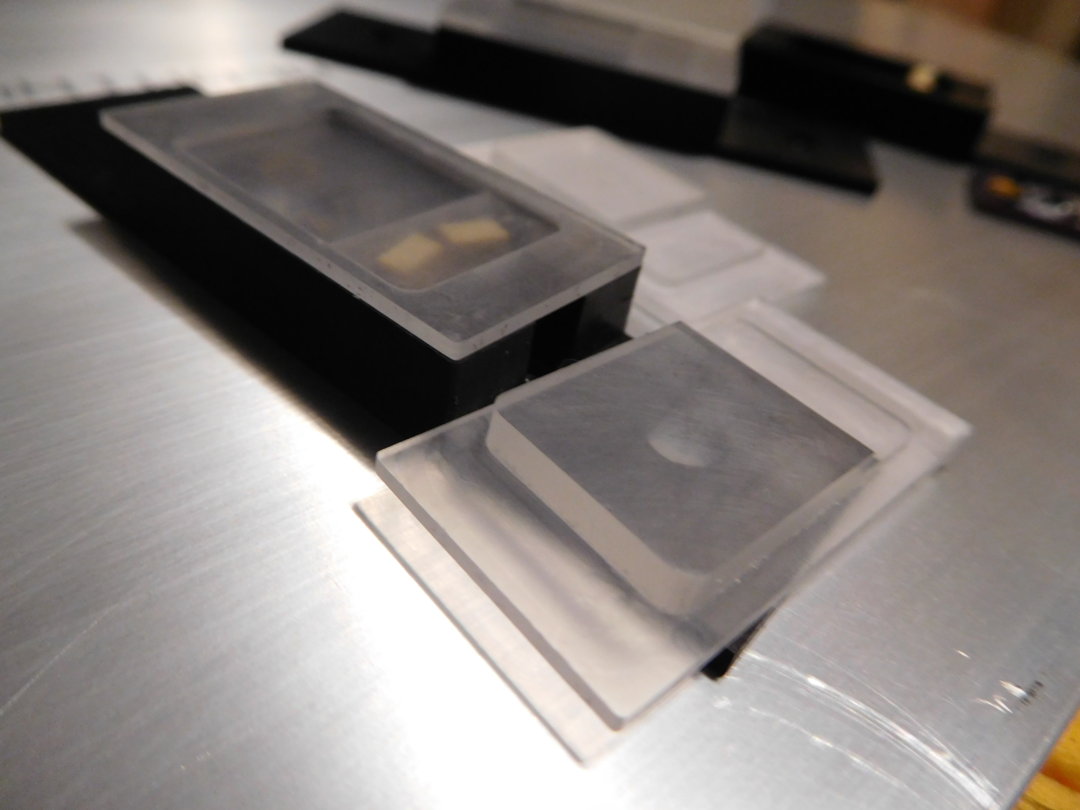

  20. Sprags
    Sprags Well-Known
    Nov 23, 2017
    154
    13
  21. Michael.M
    Michael.M Veteran
    Jan 21, 2017
    432
    270
    Oh these are hall effect limit switches. They can be sealed up and basically become a worry free, non mechanical end stop.
  22. Michael.M
    Michael.M Veteran
    Jan 21, 2017
    432
    270
    They have an LED status light to let you know when the switch has been triggered (by a strong magnet). I just need to figure out the perfect magnet bracket now. You have to make sure the magnet is facing the right way also.
