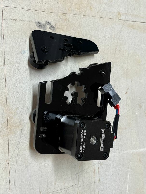

    My ACRO had a bit of a rough trip on its way here. Has anyone tried gluing these? Will acetone work with this plastic?
    Yes, I can always bond a plate on the outside and make it work but I was hoping to keep the repair as discrete as possible. Any suggestions would be appreciated.
    15,678
    4,485
    CA glue tends to bond weakly to Acrylics.
    Look on amazon for Acrylic cement - the signage industry uses it extensively for making acrylic signs. Its like a solvent, melts the two sides of the joint together.
    Thin, almost water liquid, you can flow it into gap after bringing parts together
