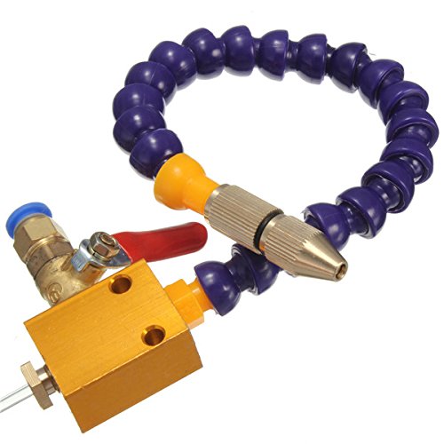

    What are others using for air-blast / air-flow in their systems?
    I have trouble finding much information around the internet. A few mention using fish pond pumps but I don't know what power rating would be adequate for this purpose.
    I'm looking at experimenting with the following parts:
    PUMP: https://www.amazon.com/dp/B072N2HPW...olid=2S18EZ1VGYGJ0&psc=1&ref_=lv_ov_lig_dp_it
    TUBING: https://www.amazon.com/dp/B01HBSU9E...olid=2S18EZ1VGYGJ0&psc=1&ref_=lv_ov_lig_dp_it
    NOZZEL: https://www.amazon.com/dp/B071DXGGP...olid=2S18EZ1VGYGJ0&psc=1&ref_=lv_ov_lig_dp_it
    Is the pump overkill?
    Any help, nudge suggestion in the proper direction is appreciated.

    A diaphragm air pump is going to be noisy - it's basically a buzzer pushing a diaphragm back and forth - make sure spare diaphragms are readily available. Also, although that one looks better than most, they don't tend to be good at pumping at pressure.
    You might be better off using a small compressor - still going to be noisy, but will switch itself off when the tank gets up to pressure.

    That is why I chose the airbrush pump for my CO2 laser vs a pond pump. :thumbsup: Two tools in one. I just went with the slightly cheaper Harbor Freight model since I could buy it locally when it was on sale.
    If we are discussing for the CNC, I just use my regular air compressor in the garage. It is a larger upright one. I just have to make sure it isn't running on the same circuit as my spindle and vacuum or everything comes to an abrupt halt when the compressor --briefly-- kicks on. Apparently a 15 amp breaker only limits you to 15 amps. Who would have guessed.:duh: My hose is a coiled one suspended from the ceiling above the machine and it is connected to one of these from Amazon. Well worth the $9.99.
    Here is how I did it if interested. Lead Screw Driven Ox Derivative (850x1500)
