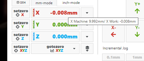

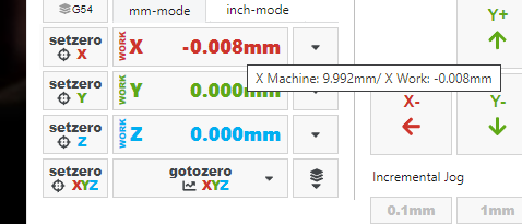

    OK last question, if you jog over to where you zero, click SetZero, hover mouse over the DROs to show the Machine Coordinates, what are the machine coordinates at Work Zero for X, Y and Z?
  7. Steven van der Scheer
    Aug 18, 2024
    Where can I find the DRO's?
  8. Steven van der Scheer
    Aug 18, 2024
    Is this what you were asking for?
  9. Peter Van Der Walt
    15,186
    4,346
    Negative. Hover over the DROs themselves to see the Work and Machine Coordinates

  12. Steven van der Scheer
    Aug 18, 2024
    i’ve attached pictures of the DRO! Thanks!

  14. Peter Van Der Walt
    15,186
    4,346
    Right, so
    Keep in mind (or if not read yet, please do Frequently Asked Questions ) that the entire machine lies in negative quadrant space. Axes Max = 0 in machine coordinates.
    Z is at machine coordinates of -18mm
    Meaning, it can move a max of 18mm before it would go outside the negative envelope in Z (i.e violate the Soft Limit)
    Yet, your GCODE:
    Tries to do a Z20.320mm lift - and correctly 20mm is more than the 18mm available, so the Soft Limit is absolutely correct :)
    Try lowering your clearances in Vectric, doesn't need to go that high. Your entire job, including clearance moves has to fit in the machine envelope.
    (Soft limits hard to understand sometimes, because it works in machine coordinates, might want to disable it and if you are really worried, fit the Min/Max endstops as shown in BlackBox Docs > Xtensions Limits section)
