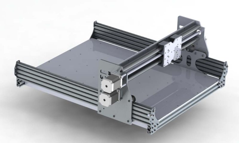

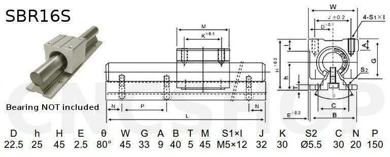

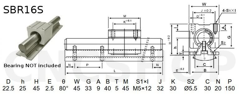

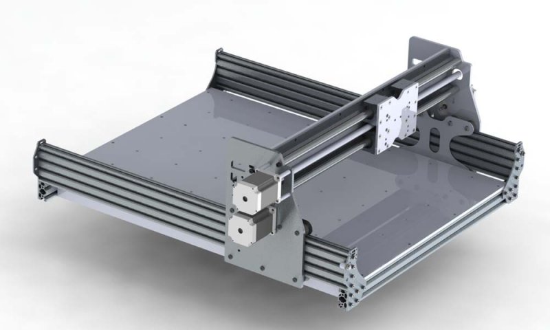

    I decided I want to try linear bearing on the X axis, with the intention to remove ALL flex and provide strong smooth movement.
    I'm planing to bolt a 1/4" * 4" * 24" plate to my X rail. Then mount two SBR16 linear rails which will also be attached to two new gantry plates. The Z axis plate mounted to the bearings is the same physical size as the original with the same mounting holes, I may change this design later but want to focus on one improvement at a time.
    See below early concept design ideas...
    #112 sgspenceley, Feb 4, 2015
    Knut Bøje, GrayUK and Hytech2k like this.
  23. Hytech2k
    Hytech2k Veteran
    May 6, 2014
    429
    332
    That's a really sharp idea. Only thing I might change is the 1/4 plate, to better resist flexing it might be a good idea to go to 1/2", price difference and weight difference is negligible and it would greatly increase the stiffness. I'm not sure exactly how your mounting the SBR's, they're on stands with a bolt pattern to mount the stand to whatever correct? The SBR's are going to also rely on the stiffness of what they are mounted to in order to resist the twisting motion of a router cutting below the center axis. Just my thoughts. Overall the concept is solid, X axis design kinda resembles the 6090 CNC, just you've added a back plate and rails with stands, should be a very rigid setup for sure. Anxious to see what your going to come up with for the Y axis !!
    Great concept !!
    Gerald
  24. sgspenceley
    sgspenceley Veteran
    May 27, 2014
    249
    295
    Thank you. The round rails are mounted and fully support along the length on an aluminium rail with bolts.
    I'm thinking about using the same concept for the Z axis but smaller versions.
    My logic was the original beams bolted together, 1/4" plate & these beams bolted through both was over engineered... But physical testing will provide the honest answer.
    Your 100% correct the cost difference would be small to go from 1/4" to 1/2", plus I could then add cross bolts to the gantry plates. The is in addition to the cross bolts which go into the end of the rails.
    Your guessing right, X axis is step one in multiple re-design approach. But that one I think will be rack & pinion like you approach.
    I originally started the project to cut carbon fiber & G10 sheets, now I'm thinking why not make it strong enough to accurately cut aluminium. Motors & electronics are the same... The machine just needs to be stiffened up... Which is a fun design challenge!
    #114 sgspenceley, Feb 5, 2015

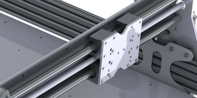

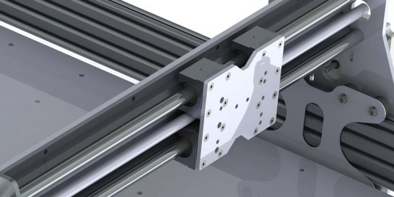

    I have been adjusting the Z axis wheels to try to remove the flex on the Z axis. Have other people found that the Z axis has a good amount of flex even when light pressure is applied?
    I have redesigned Z axis with linear bearings SBR-12's, 1/2" 5 start thread. I ordered some good quality pillow block bearings for the threaded rod.

    Hi Steve. Are you seeing the flex when mounted to the original extruded x-beams, or as a subassembly on the bench? It's hard to tell size by your pics, but the linear bearings and shafting look kinda small by comparison to the original aluminum extrusions. I have no feel for this because I do not have a machine yet, so have no hands on experience. But I could see those shafts flexing sooner than the original extrusions.
    sgspenceley likes this.

    Hi Dave, I honestly don't think the flex in the original design is the aluminium extrusion in the Z axis or X axis. I think the flex comes from the wheels in the V channel. Plus the front & rear Z axis plates only have 5mm bolts holding the whole carriage together. When I first assembled the X carriage I put the wrong size spacers in the center and was shocked to see how much the 5mm bolts bowed!
    Many CNC machines use the round rail system and linear bearings. My gut feeling was linear reals which are mounted along the full length would be even stronger when mounted to a 5" tall plate.
    The X axis still has the original 20 * 60 double beam which is bolted together, so when you combine this with an aluminium plate & these linear rails which are also bolted along the length, I don't imagine seeing the X flex or twist. But we will see!
    If I do then I will replace the two 20 * 60 beams with something much beefier.
    The original design is not bad, I'm just having fun doing the mod's and design work.
