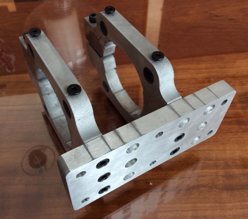

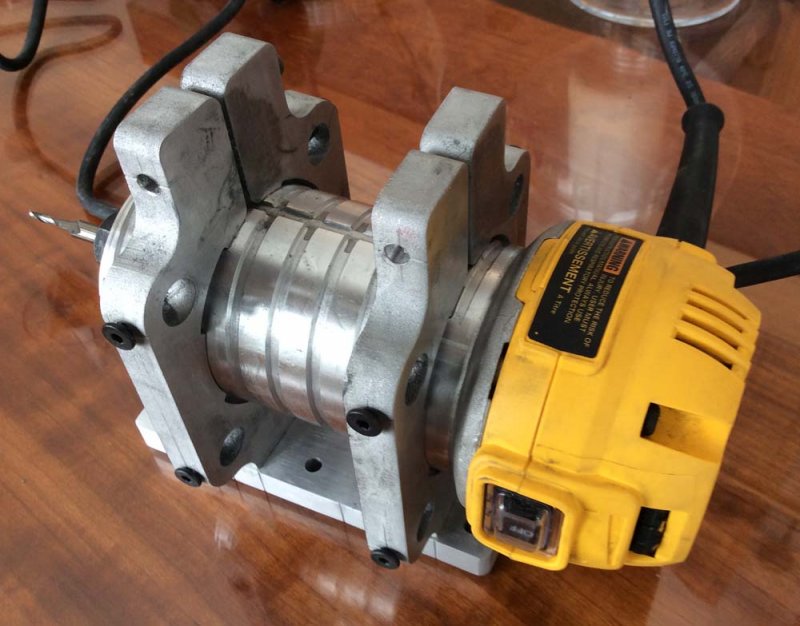

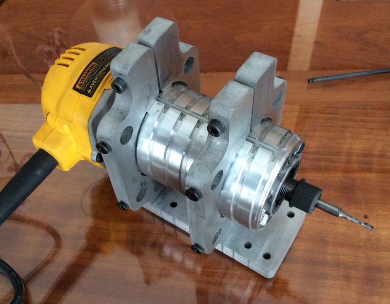

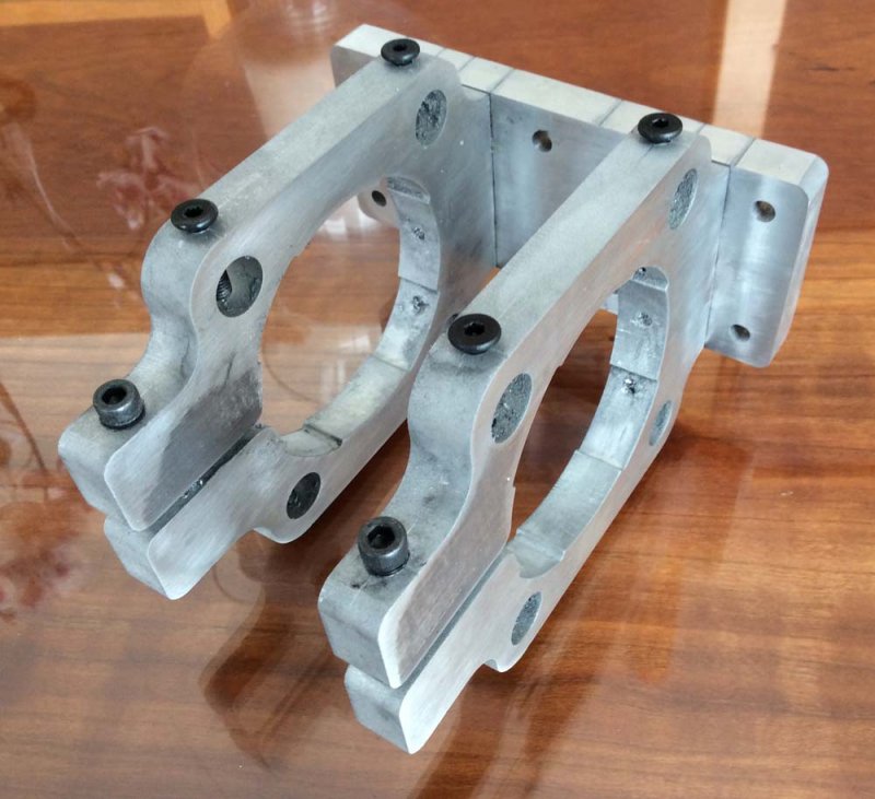

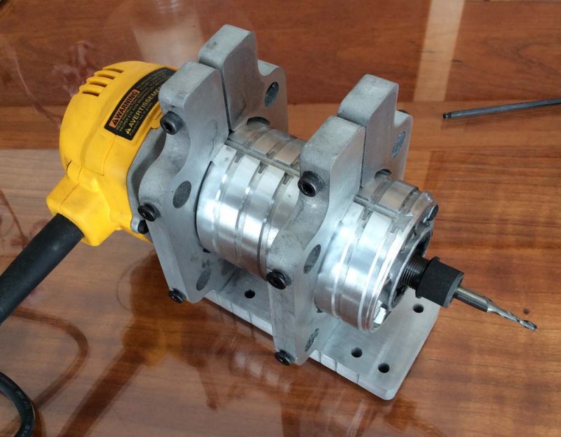

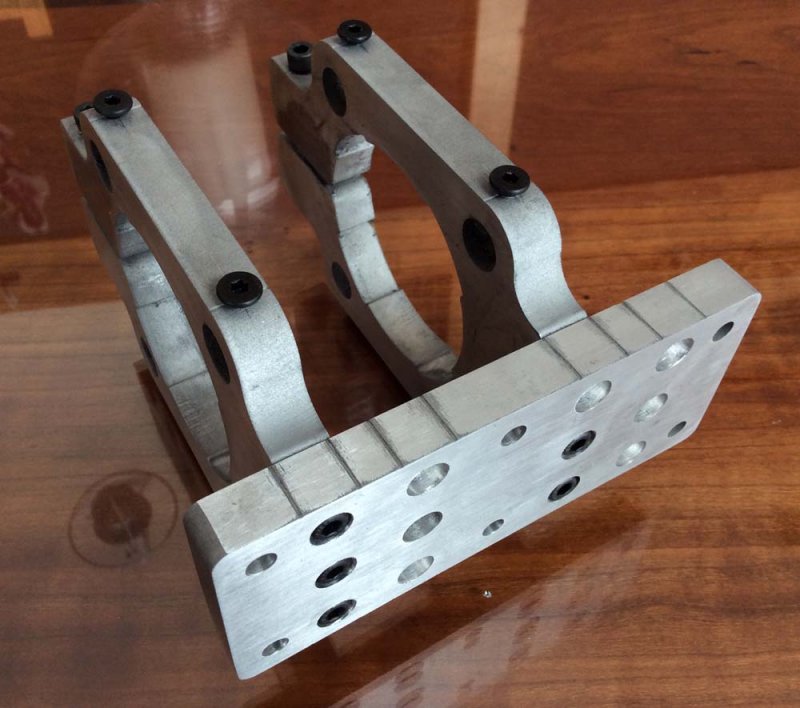

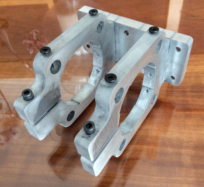

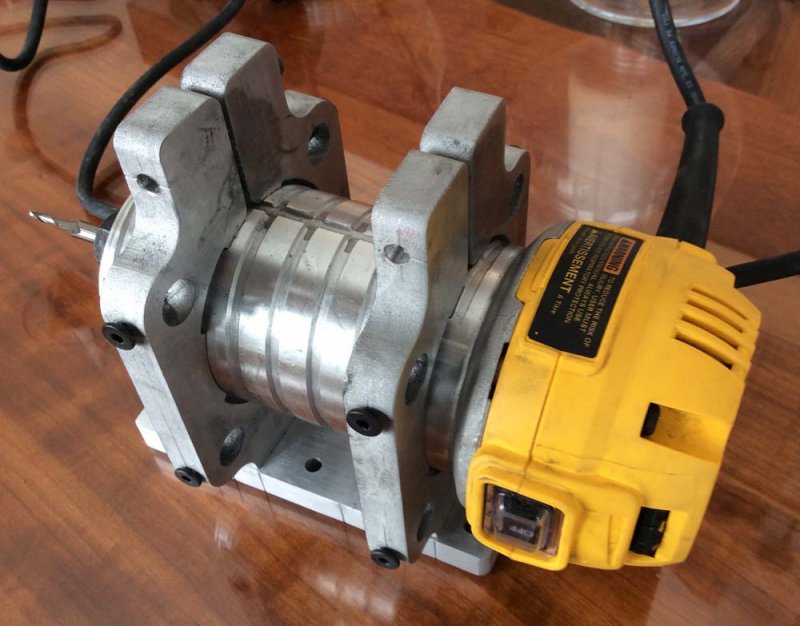

    I had a 1/2" thick aluminium router mount bracket water jet cut last week. Today I did the drilling & tapping of the holes.
    A very solid mount, happy with this!
    RouterMount1.JPG RouterMount2.JPG RounterInMount1.JPG RounterInMount2.JPG RounterInMount3.jpg

  26. Nick W
    Nick W Well-Known
    Oct 22, 2014
    99
    61
    Looks solid enough for anything that router can dish out.
    sgspenceley likes this.
