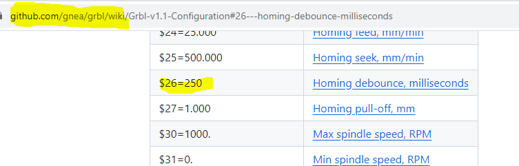

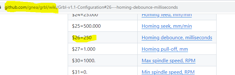

    You changed the Homing Debounce to a factor of 10 less than its default / what should be.
    Read the Grbl Wiki, and avoid changing advanced parameters without understanding their impact
  5. jawbrkr
    jawbrkr New
    Feb 15, 2023
    That is an artifact when the limit switches wouldn't trigger, because I didn't have "$5=7 ; Invert limit pins, boolean/mask" set correctly.
    I fixed $26 value, everything yields the same result, 50ms, and 250ms can home if the hard limit switches are disabled just fine. When enabled, it still triggers immediately and I'm unable to home the machine still.
