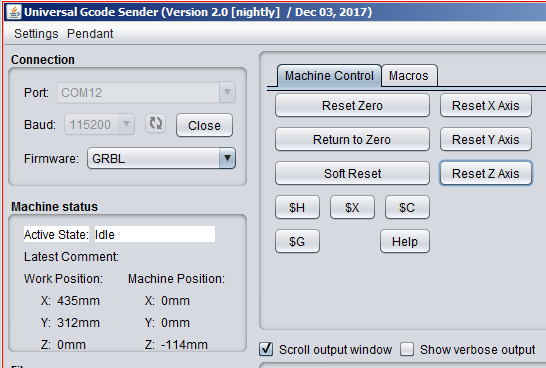

    hello,, I'm new to this cnc business,,, I have a small desktop cnc for engraving and routing into wood. ive been able to get my images into g code for the grbl and Arduino powered cnc,,, my problem is that when I send the code to the machine,, it doesn't get all the way down to my material. ( 1/4 inch plywood) what am I missing? thanks in advance. (ive attached the file that I'm trying to engrave onto the plywood)
    • part.nc
      File size:
      478 KB
      Views:
      185
  4. David the swarfer
    3,604
    1,978
    Your code has a tool change command that GRBL cannot process
    T0 M6
    remove that line
    then there is the question of 'where is zero?'
    you need to set the set the tip of the tool on the surface of the wood and set Z=0 at that point.
    you don't say which GUI you are using otherwise I could give specific instructions.
    Here is an example from UGS
    you can see that the machien position for Z is -114mm but the current WORK position is 0.
    I did that by jogging to where I want it then pressing the 'reset Z axis' button.
    BTW if you are using UGS 1.0.9 then you need to update to the latest stable or nightly build

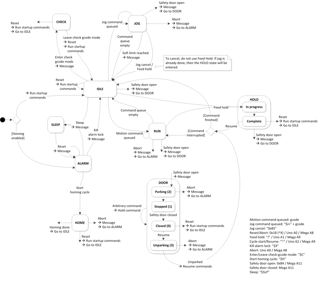

  7. Patrick Meijers
    Dec 21, 2017
    I have made a picture about the state machine of GRBL, from how I understand it from the wiki documentation.
    Probably nice to share and also hear if anything important is missing/incorrect.
    Grt, Patrick
