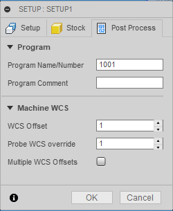

    Thanks for the help so far David! I am guessing you mean this? upload_2018-5-8_4-16-3.png Now what about the homing in the PP options? Leave them defaults or how do I set them?

    One does not home at the beginning and end of a job. One homes when the machine is turned on, or after a crash.
    after that you set the Work Coordinate to your reference on your raw material. Then run the job.
    You should rather 'go home' after the job.
    there are several ways to do this but I like these 2 lines
    G53 G0 Z0 ; raise Z up for safety
    G53 G0 X0 Y0 ; return to home
    but this assumes that going to 0 will not hit a home switch and cause a limit error.
    That is what the -10s are for, to stop short of the switches to avoid errors.
