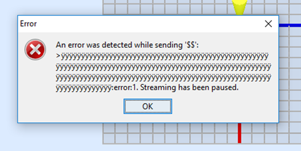

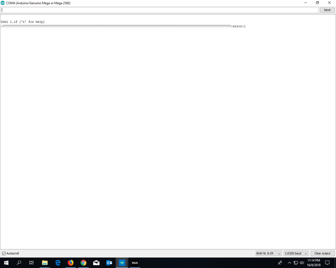

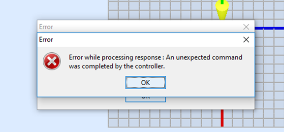

  9. Lim Shi Hao
    Jul 13, 2015
    Hi there, just your normal beginner here. I am running GRBL on a arduino mega for a Chinese cloned c-beam machine. I am having this weird error which I can't seem to resolved after clicking return home button on Universal G-code Sender and restarting my computer.
    Here is a screenshot from the Arduino IDE:
    and the errors for the universal G code sender
    Does anybody have a clue on what is going on? Thank you.
  10. HPB
    HPB Well-Known
    Nov 28, 2015
    80
    53
    Looks like a mismatched baud rate (Perhaps!). Also looks like it’s the UGS nightly? You may want to try grbl on an Arduino Uno with the stable version of UGS.

  13. Lim Shi Hao
    Jul 13, 2015
    I am using GRBL for mega. I flash V1.1f Hex file (gnea/grbl-Mega) using Xloader. The problem begins after I pressed return to home after test jogging it. It just keep popping the same message "infinity" until I either shut down the computer or disconnect the mega.
  14. Lim Shi Hao
    Jul 13, 2015
    Many Thanks to Gary Caruso and HPB. In fustration, I clear the EEPROM of my Mega and re-flash the GRBL firmware. The problem has been resolved.
