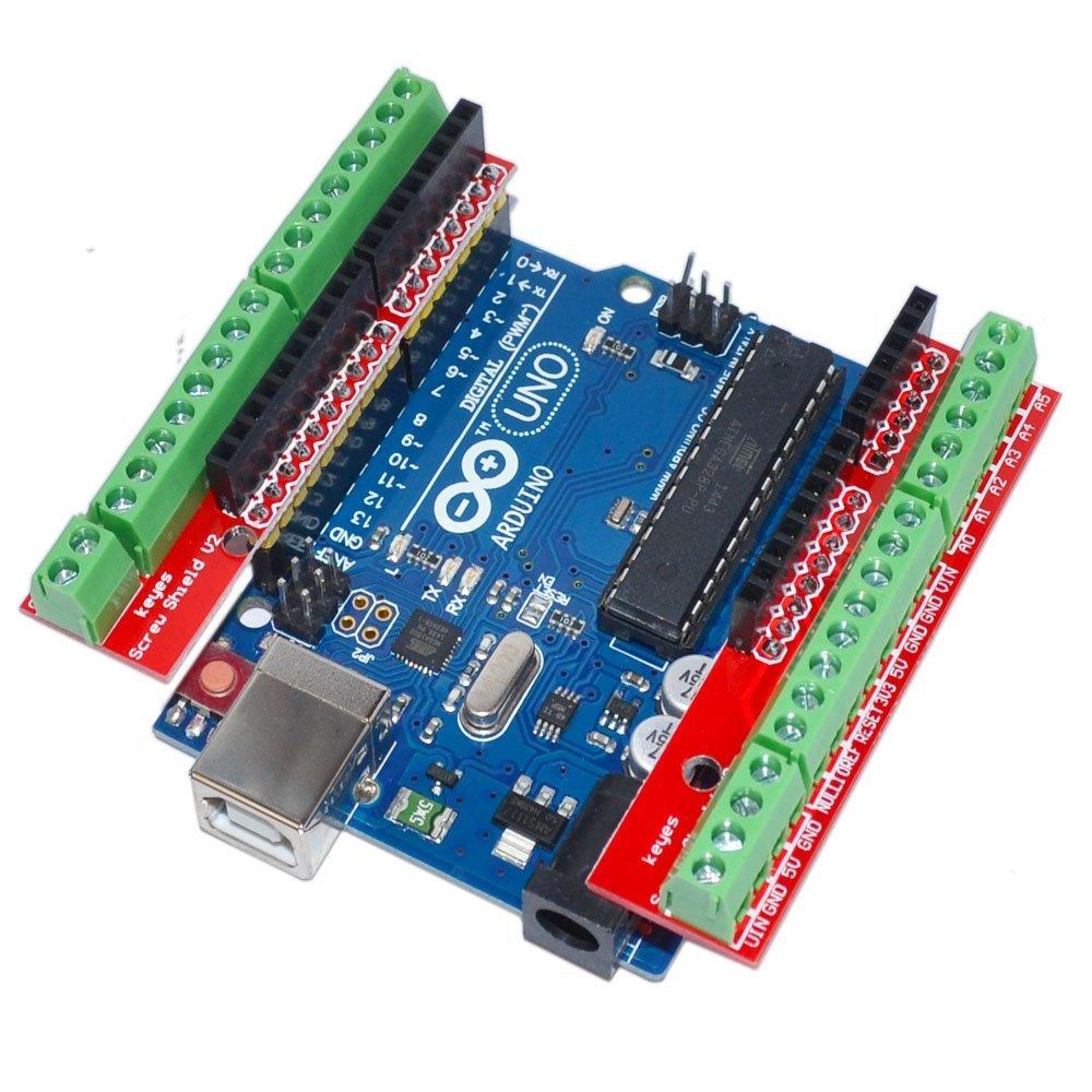

    You would use those drivers instead of a CNC shield, not with it. Well, I guess you could use it with a CNC shield, I think they do have connectors for the various drivers on the top of the board. You'd have to look at the schematic of the CNC shield. I don't think you'll find any plug in drivers for the CNC shield that will handle 4A. The 8825 drivers only handle a bit over 2A, and that's with a heatsink and fan.
    I use my arduino with a screw terminal shield, and just wire the step, direction, enable, and 5v into the stepper driver for each axis, based on the arduino GRBL schematic:
    This is an UNO with screw terminal shield

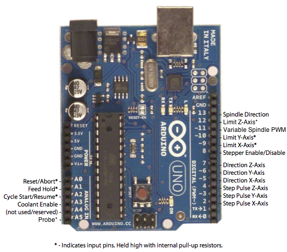

  4. Giarc
    3,062

    Great find Metalguru. I love the screw shield. I think I will go this route.

    I might go with a screw shield . I was using the Cnc shield to make wiring easyier since things are labeled .

    Make sure you have wired your limit switches to the correct pins. X->pin 9, Y->pin 10, and Z->pin 12. Z has recently moved from pin 11 to pin 12 to access the hardware PWM output in pin 11 for variable spindle speed output.

    I think the switches are wired ok: Y_limit is D_9: X_lim is pin D_10 and Z_limit is pin D_12 on my diagram.
