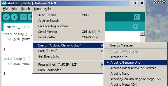

    @Dave, I altered the file and clicked upload. No error message this time but after the green compiling meter/bar filled up and disappeared, it still says "Uploading" in the blue bar at the bottom. It's been this way for about 15 min now. I'm thinking that something still hasn't gone smoothly.
  8. David the swarfer
    3,595
    1,967
    Google tells me this is often related to selecting the incorrect board/chip. So make sure you have an Arduino UNO with an Atmega328p chip, and also make sure you have selected that type of board in the ArduinoIDE.
  9. Joe Pineapples
    Jul 26, 2016
    15
    I don't though, I have a Mega2560!
    It looks like this may be my problem... [SOLVED]no programmer has been specified on the command line or the config file - Page 2
    Will have another look tonight. Thanks again for response.

    Well, I tried rolling back the AVR board version to 1.6.10 and when that didn't fix the problem I took it further back to 1.6.9 but it still isn't working.
    There are fewer orange error contents now though, so it's getting somewhere at least.
    I'm considering throwing the Mega2560 in the bin and just buying an UNO. Are there ever issues like this when uploading to the UNO?
  18. Sonny Jeon
    Sonny Jeon Well-Known
    Aug 6, 2015
    165
    66
    Honestly, I'm not sure why you are having so much trouble uploading Grbl to an Arduino. It's fairly straight-forward. First, is Grbl successfully compiling? If so, it's not a Grbl problem, but an Arduino/host computer issue. Second, do you have an authentic Arduino Mega or a clone? Third, I've run into a problem with USB 3.0 ports. If you are connected to USB 3.0, try a USB 2.0 port or hub. It seems to fix weird issues like this one.

  20. Joe Pineapples
    Jul 26, 2016
    15
    It appears that the problem may have been with the old laptop I was using. I've just tried to upload GRBL at work from a desktop PC and I think it might have worked. I'm not entirely sure though because there are a couple of lines at the bottom of the screen which mention something about invalid libraries for GRBL.
    Took a shot of the screen in case it means anything to others on here...
