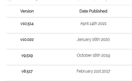

    Hello!
    After copying the post processor file "openbuilds_mm.pp" into the postprocessing Aspire folder named PostP (I'm using Aspire version 9 on win10) I then experience an immediate freeze while launching Aspire; all menus don't work if clicked and after some minutes 2 or 3 error messages pop up (please see images attached here).
    and sometime a third error on line 75 "Spindle on"
    Is there a way to fix this?
    Cheers
    Builder Resident Builder
    15,699
    4,509
    version 9? Doesn't look like there was a version 9 (according to Program Updates | Vectric). Even 9.5 is almost two years ago. You'd have to upgrade to a more current version. Our Post is meant for V10 and up
    If I may ask, is it the virus ridden pirated version? If so, they have free trails: Free Trial Comparision | Vectric if you were just looking for a test drive, or if you are a paid up v9.5 customer, you could have upgraded to 10 and then 10.5 for free

    ok thanks Peter,didn't know the upgrade was necessary! I have no idea if this version is pirated or not since I am using an old laptop with this version loaned to me by a friend. Seeing how bad it works, the version is probably pirated because it keeps crashing. I will change it as soon as possible.
