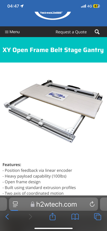

  7. Mark Tomaras
    Apr 18, 2025
    Thank you very much. I have been searching online for inspiration and I found these two systems that I thought looked like possibilities. Both are quite different. Of course, I am also looking for relative simplicity. I certainly do not want to over engineer anything for the obvious reason that I have never done this before and also for budget reasons. I don’t mind a manual system at all, but if cost and complexity are similar, I may prefer a motorized version.

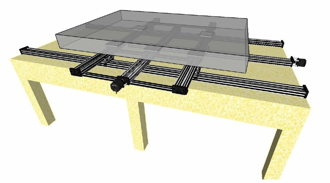

    Attached is my best suggestion. Right now, motion is limited to around 850 mm x 1350 mm due to the limitations of 1500 mm extrusions. The two long rails on the upper section and the drive rail on the lower section will need to be increased to about 1650 mm in length to achieve the full 1000 x 1500 mm range of motion requested. Increasing the drive rail to 1650 mm in length does present some issues with the lead screw whipping but as this is a low-speed endeavor, it hopefully won't be a problem. There are solutions however if it is. You will need to verify if you can get 1650 mm C-Beam extrusions and 1690 mm lead screws in your market.
    Sketchup files attached below.
    Note: there is a minor conflict at the non-motorized end of the lower lead screw. The end plate sticks up a bit too far to clear the upper framing even with the 15mm plywood shims shown on the gantry plates. You will either need thicker shim plates to provide clearance or trim off the top of the end plate.

  11. Rick 2.0
    2,904
    1,559
    The reality is, there is no such thing as perfection in the built environment. The best anyone can hope for is acceptable tolerances. And only you can determine what the acceptable tolerances are with your system. So let's go over where errors may happen and how to best mitigate them.
    The framing is designed such the center of mass will always be between the two base rails so you don't have to worry about uplift at one end of the upper gantry causing rotation when the table is moved to the far opposite end. That solves one problem but doesn't resolve how to deal with system deflection and imperfect rails. Deflection of the upper rails shouldn't be an issue based with the way the gantry plates are spaced out but ultimately will be dependent of the weight of the vacuum box. The heavier the box, the more the potential for deflection. If it becomes an issue, the best solution would be to spread the base rails out even farther and add another support rail down the center.
    As to the issue of imperfect rails, it's pretty much a given that extruded aluminum rails are not perfect. It is important that you check them when you receive them to verify that they are within your acceptable tolerances. On the lower rails, some slight bow may be eliminated when the rails are fastened to the table but the upper rails will need to be pretty much dead-on perfect. Straightening there can be aided by adding a center rail on the lower level but this should only be done as a last resort.
    One final thought on the framing involves the splice in the bottom rails. The bottom rails are shown at 2400 mm which exceeds the available length of C-Beam. Arbitrarily, I have shown the splice in the center but that may or may not be a good location depending on how smooth the transition across it is. You will want to set up test fits when you receive the rail and run a properly fitted gantry plate assembly across the joint to verify smoothness. (I would suggest inserting a tight-fitting 20x40 mm piece of wood blocking or aluminum tubing in the channel of the rails to help achieve proper alignment.) If you can get 2000 mm lengths of the extrusion, you may also want to consider setting the lower rails up with a 2000 mm section in the center and 200 mm pieces spliced on to both ends. While this would create the potential of having to cross two spices, it would mean that for the majority of work that is not using the full table width, you would not have to cross a splice at all.
    The final part of the necessary precision is up to you. You cannot expect laser level precision without doing a laser level precision build. Make sure your table is stout enough there is no deflection. Framing members should span the short direction, not lengthwise. Using slotted hold down clips for the base rail may help with tuning the framework. You might also want to consider mounting dial indicators on your camera mount, pressed against the surface of the vacuum table and moving the vacuum table around to verify flatness.
    So good luck with this, keep us informed. We love to see successful builds. Be sure to source quality OpenBuilds parts to the greatest extent possible. There is nothing more expensive than cheap parts so avoid the direct from China mystery vendors. They don't demand the same level of tolerances in their products. The OpenBuilds parts store can give you a list of authorized resellers in your part of the world. And finally, please remember that as I am a volunteer moderator on this forum and not an employee of OpenBuilds, OpenBuilds itself offers no warranties as to the suitability of the outcome. I do however have many, many years as a structural engineer so the probability of success here is extremely high. But no matter how good a design is, ultimately the success or failure of a project often comes down to the care and precision used while constructing it. And that part is on you.
