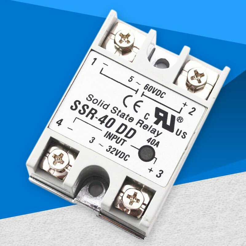

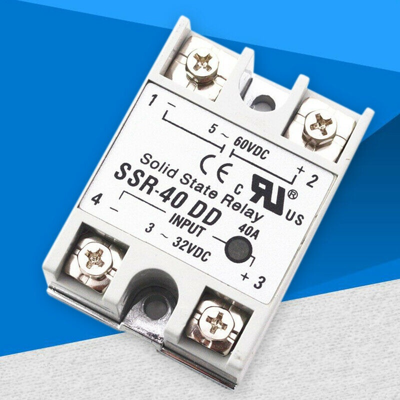

    Only other solution I can think of which may be suitable is to use a solid state relay which would seem to avoid the problems mentioned above as they are switched using very low currents/voltages. Bear in mind, my setup uses its own separate 36v Power supply for the spindle and another 24v volt supply for the BB board.
    This sort of thing maybe?..
  10. Peter Van Der Walt
    15,232
    4,349
    :) more bad news, but DC SSRs doesnt like inductive loads (;
    Didnt know you were in the UK, but worth checking for similar locally
    Do understand, we will recommend the safe solution, and not give input on wiring mains yourself (liability reasons...). Get an electrician in (; and let them wire an AC SSR to turn power to the 36v psu on. (The DC side is inductive, high current, and very dirty power from all the motor back-emf).
