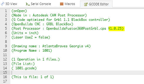

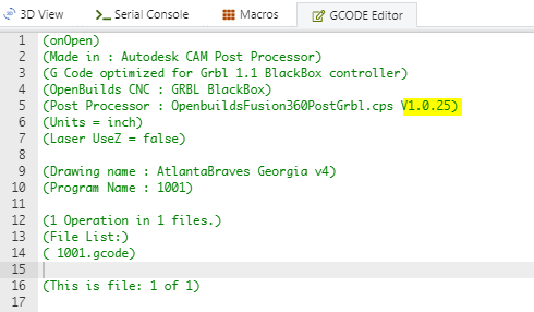

    there have been alot of changes and some bug fixes since .25 so please update ASAP and regenerate the Gcode.
    OBControl (and others) does not show moves correctly unless there are Z moves.
  9. David the swarfer
    3,604
    1,977
    initial look at the gcode says , yes, there is a problem there since there are no G0 codes except the first move.
    This is probably because you have the personal license and it (Fusion) does not output G0 moves. I think I did
    fix this in the post, upgrading and regenerating will prove it one way or the other. You should see G0 moves around the pierce comments.
  10. NickEng
    NickEng Well-Known
    Sep 10, 2020
    152
    18
    Here is the gcode with the updated post processor. The 3d image still looks the same, but this is normal? I have not tried to actually burn it.
    Edit: if I am looking at it correctly, it still doesn't appear to be right. I don't see the pierce comments on the updated version, but at this line G4 P1.8 there are no G0 other than the first one.

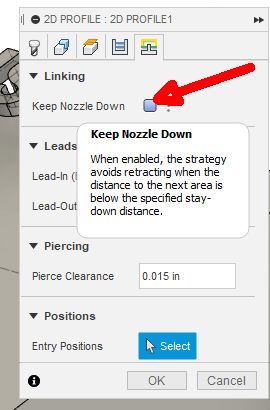

  18. David the swarfer
    3,604
    1,977
    I believe the problem is the way you have placed the various parts of the drawing at different heights.
    Things that are below the top of the stock box do not get 'retracts' and therefore do not get a rapid move between them.
    So selecting all the letters in 'National' gets no rapids (top faces below stock box), but selecting the
    shapes on the left gives rapid retracts since the faces are at the level of the stock top.
    so, make all the bodies share the same top level and then all the outlines of the tops should cut properly.
    nope, wrong.....
    turn off 'keep nozzle down' in the linking tab

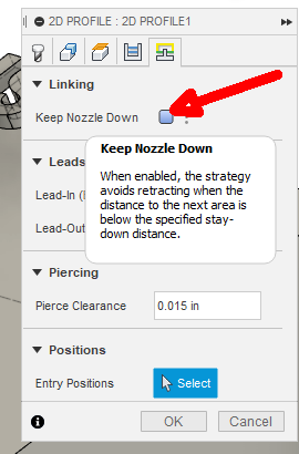

    Ok. Thanks! I thought I tried that but I guess not. What exactly does the “keep nozzle down” do? I have checked it before and it was beneficial for something but I can’t remember what?
  22. David the swarfer
    3,604
    1,977
    It is really for plasma cutters which have Z motion.
    With it off, the nozzle will lift after every cut before moving to the next cut, then has to descend before starting the cut.
    This takes time and is not always needed, but some plasma cutters need it for the automatic height control to work its magic.
    Turning on 'keep nozzle down' will thus prevent these retracts so long as they are shorter than the maximum keep down distance, so longer rapids will still retract, depending on the settings.
    In our case GRBL is automatically controlling the laser on/off for us (Grbl v1.1 Laser Mode · gnea/grbl Wiki).
    Since we are using M4, we need the retracts to trigger G0 moves in the post, otherwise Fusion is not giving us G0 moves between cuts, instead I believe it is giving onPower events to turn the laser off and on which this post does not make use of (yet, maybe it should - but only if 'keep nozzle down' is on).
    Given that we are using M4 we do not want M4 and M5 sprinkled around in the Gcode since that interferes with the speed advantages of using M4 in the first place.
    However, if we want pierce delays then we have to use M3 mode when cutting, but not when etching, which will introduce a whole new level of if..then...else...but...except logic in the post (-: Starting to make sense to do a laser specific post, then there is less to go horribly wrong.
