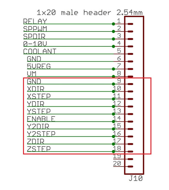

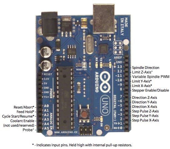

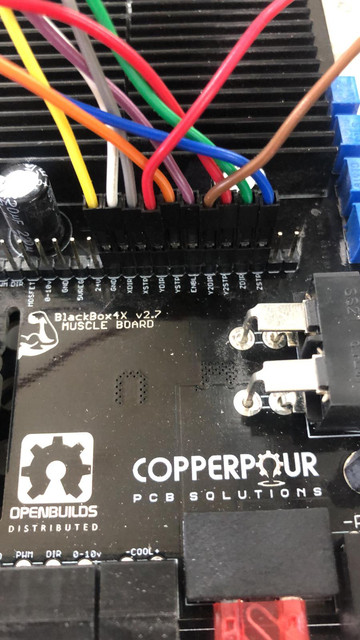

    its easy you need Male to Female Jumper Wires
    connect between muscle board and uno as photo :
    connect all wires from blackbox to uno as showin red rectangle
  8. MusaedQ8
    MusaedQ8 New
    Jun 4, 2020
    this
    forget about limit switches at least for now
    if you need more info let me know
    good luck
  9. Glenn Coombs
    Apr 30, 2020
    Hi Musaed, Where does the Y2DIR and Y2STP go?

    Hello
    Sorry for the late reply
    same Y1
    Y2DIR and Y1DIR go to YDIR(UNO)
    Y2STP and Y1STP go to YSTEP(UNO)

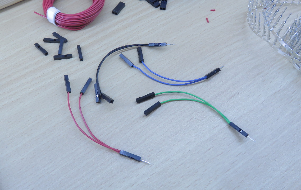

    make your own cable like this or find same online
    but ofc make it longer than this
    find the right way for you
    good luck.
