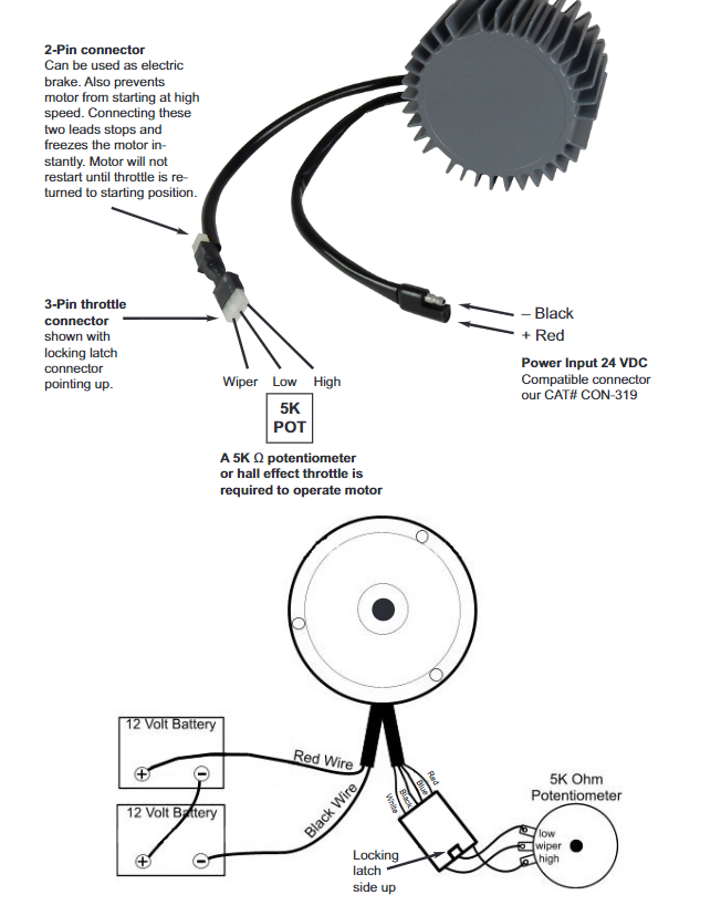

    Hello!
    I'm trying to use this brushless motor as my spindle motor for my harbor freight cnc mini mill conversion.
    https://www.allelectronics.com/item/dcm-2460/24-vdc-brushless-motor-600-watt/1.html
    It uses a 5k potentiometer to control the spindle.
    Would I be able to wire this into the blackbox for spindle output without a VFD?
    I am planning on putting a hall effect sensor to track spindle speed.
    https://www.amazon.com/dp/B00VKAT8A2?psc=1&ref=ppx_yo2ov_dt_b_product_details
    Any help is appreciated.
    Thanks!

    Sadly no, they don't seem to accept PWM or 0-10v (both industry standard) control signals

    How unfortunate. Would it be possible to translate those control signals? @Peter Van Der Walt
    Builder Resident Builder
    15,699
    4,510
    Not easily no, but you are welcome to discuss the need with the motor/motor controller vendor - see if they have a way to accept the standard signals. Or perhaps a different motor controller
