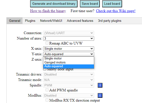

    My first post on here, been reading a lot. I'm putting the final touches on a Stronghold One machine. I'm seeing that the gantry is running slightly out of square.The frame itself is square.
    I've been looking at setting up autosquare on the blackbox V32
    So: can autosquare be done on a Blackbox, or not?
    If so, could you point me towards a resource for it,
    if not, how do I go about squaring the gantry?
    Thanks in advance,
    Peter
    Builder Resident Builder
    15,700
    4,502
    Go to http://svn.io-engineering.com:8080/?driver=ESP32&board=BlackBox X32
    Setup custom options as needed (Eg setting Y to AutoSquared)
    Generate and download
    Flash using CONTROL
    Wire Y2 switch parallel to Z
    Note the other discussions on forum - the warnings are quite valid. Don't use motors to pull a skew machine into square. Fix it by tramming! Tramming: A generic guideline

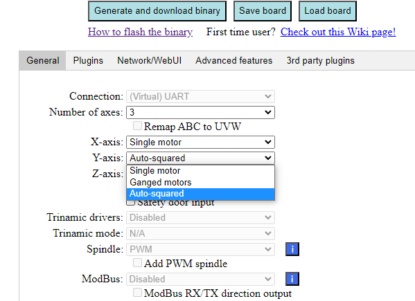

  20. TopDawg1750
    Feb 4, 2019
    13
    There seems to be a lot of confusion for Y axis auto-squaring. With a perfectly squared machine things can happen that cause the Y axis motors to go out of sync. I followed Peters link "http://svn.io-engineering.com:8080/?driver=ESP32&board=BlackBox X32" Selected Y axis auto-squared, clicked" Generate and download the firmware". I flashed the blackBox x32 with the new firmware. I spent some time getting the homing directions setup correctly and auto-square works wonderfully.
    I am using inductive proximity sensor switches on all axis. I placed one on each end of the Y axis and wired them in parallel. Select the Home icon and the Z axis homes to the top and backs off correctly then, X and Y start moving toward their respective home. The Y axis hits one of the limits and backs off then goes through a procedure to determine that is is an equal distance from both Y limits. (The process moves one Y motor at a time so It can determine which limit it is hitting). I adjusted the limits to make sure the Y axis motors sync up.
    I have attached my settings file because there are several settings that must be correct to make this all work. Your settings may differ.
    I hope this helps to clear some of the confusion.
