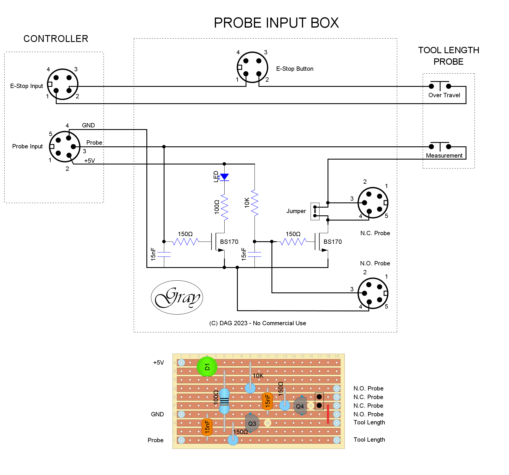

    I have tool height and 3D probe working as NC while retaining the standard NO 'touch' probing on a single probe input. It just needs a simple electronics box to combine the signals.
    All probes can be left connected and any can be used without having to un-plug or switch anything. The Jumper is there to short the second N.C. probe position if it isn't connected. The controller needs to be set for a N.C. probe.
    The diagram also showns connections linking the over-travel switch on the tool height sensor to the E-Stop input on my controller - just ignore these connections if your controller doesn't have an E-Stop input. (You can make it even simpler if you don't want LED confirmation of probe state - omit the LED, the transistor connected to it, the two resistors and the capacitor.)

    Nice work, that's a very easy circuit to make. Are you running this on a BlackBox?

    No, it's a homemade ESP32 controller running Grbl_Esp32, but that shouldn't make any difference - the probe input will work the same. (The Black Box doesn't have an E-Stop, so ignore that part.)
    NB!! Just in case: The pin numbering on the diagram refers to my controller ***NOT*** the Black Box - you would need to find the probe input, ground and +5V on the Black Box connectors.
