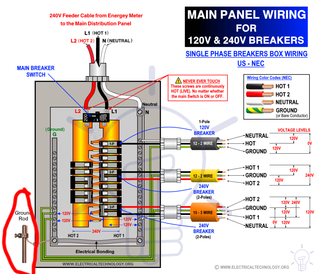

  8. Giarc
    3,062
    1,716
    DC ground is NOT the same as earth. Do not connect it to DC ground. You could damage the electronics. The ground on the limit switch goes to the black box which is connected to the 24V power supply. So, technically yes they share that common DC low voltage ground. "Earth" is also referred to as ground in High Voltage (1100r 220V). But Earth goes to an actual rod buried in the earth outside your house circled in red. upload_2023-4-12_20-8-25.png

  9. Trevor Farnum
    Feb 15, 2017
    57
    Isn't that mains earth? No different than plugging into the ground on my power supply? The ground on my power supply goes to the ground on my outlet, which goes to the mains earth ground spike outside. I thought that was bad?
    I'm going back to my conversation with Peter (Limit Switch Grounding). The last post was to go to "DC GND or a separate Earth Spike". I don't have a separate earth spike, so thought DC GND would fit the bill.
    At this point, I think the safe play is to just cut the shielding off and hide it inside heat-shrink tubing. Not ground it at all and rely on the OpenBuild limit switch's ability to run without shielded cable.
