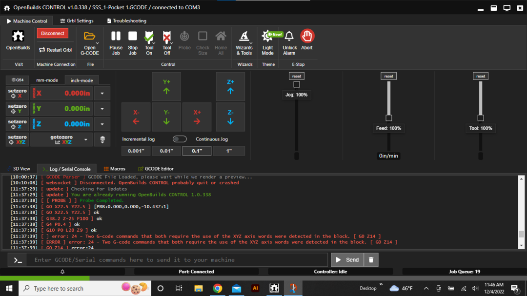

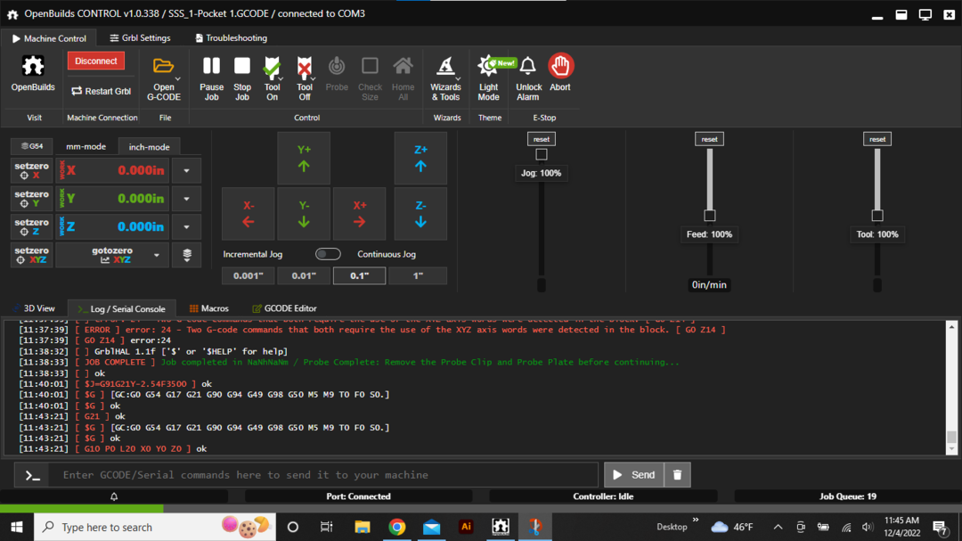

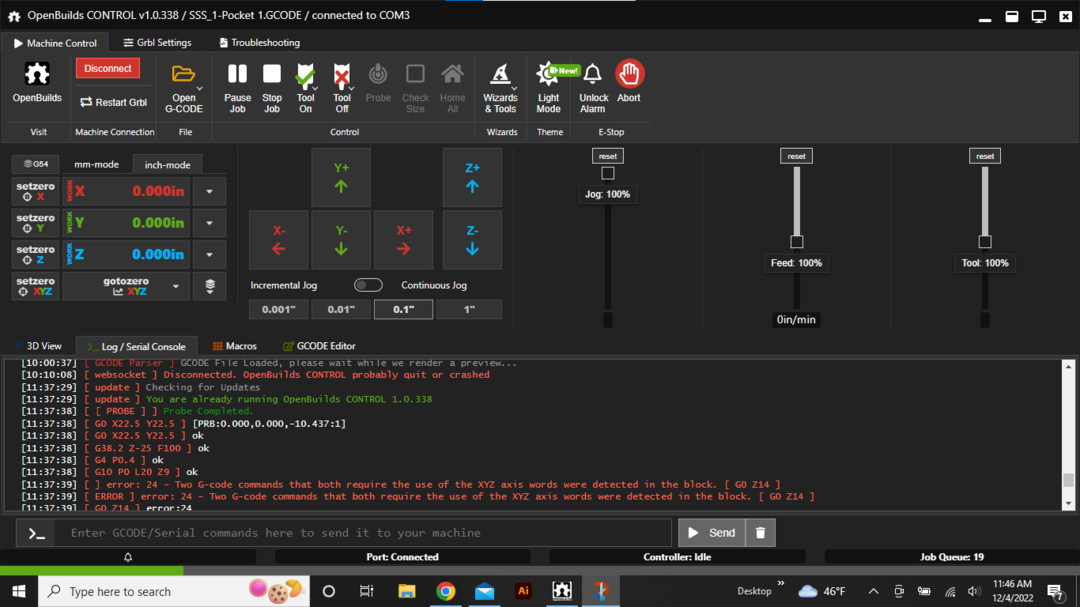

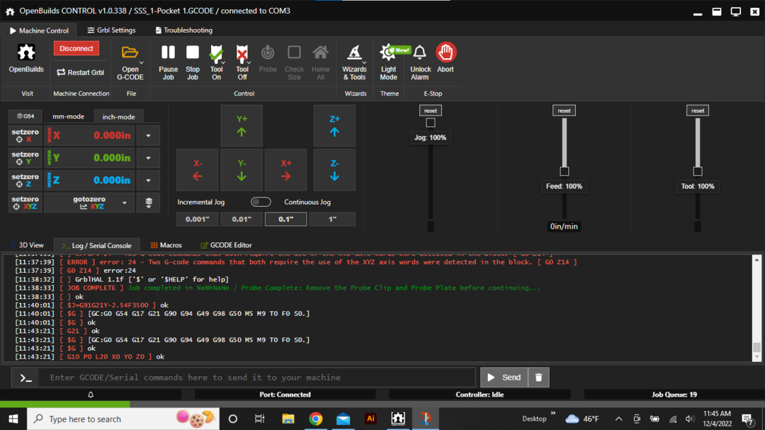

    I hope this is what you need. When I turned the power back on it wants to find the Z Hight and then stopped. So I ran it one more time and got the same ending, no movement. thank you for your time helping me through this.

    Can you please elaborate on this? When does it move Z? When you power up? When you Home? Or when you Probe?
    #11 Peter Van Der Walt, Dec 4, 2022
  12. Adam Bivens
    May 17, 2021
    19
    as soon as I turn it back on.
  13. Peter Van Der Walt
    15,195
    4,346
    Was it turned off with moves still in the queue? I see 19 moves in the queue there in the screenshot. Have you tried with a clean start of the computer?
