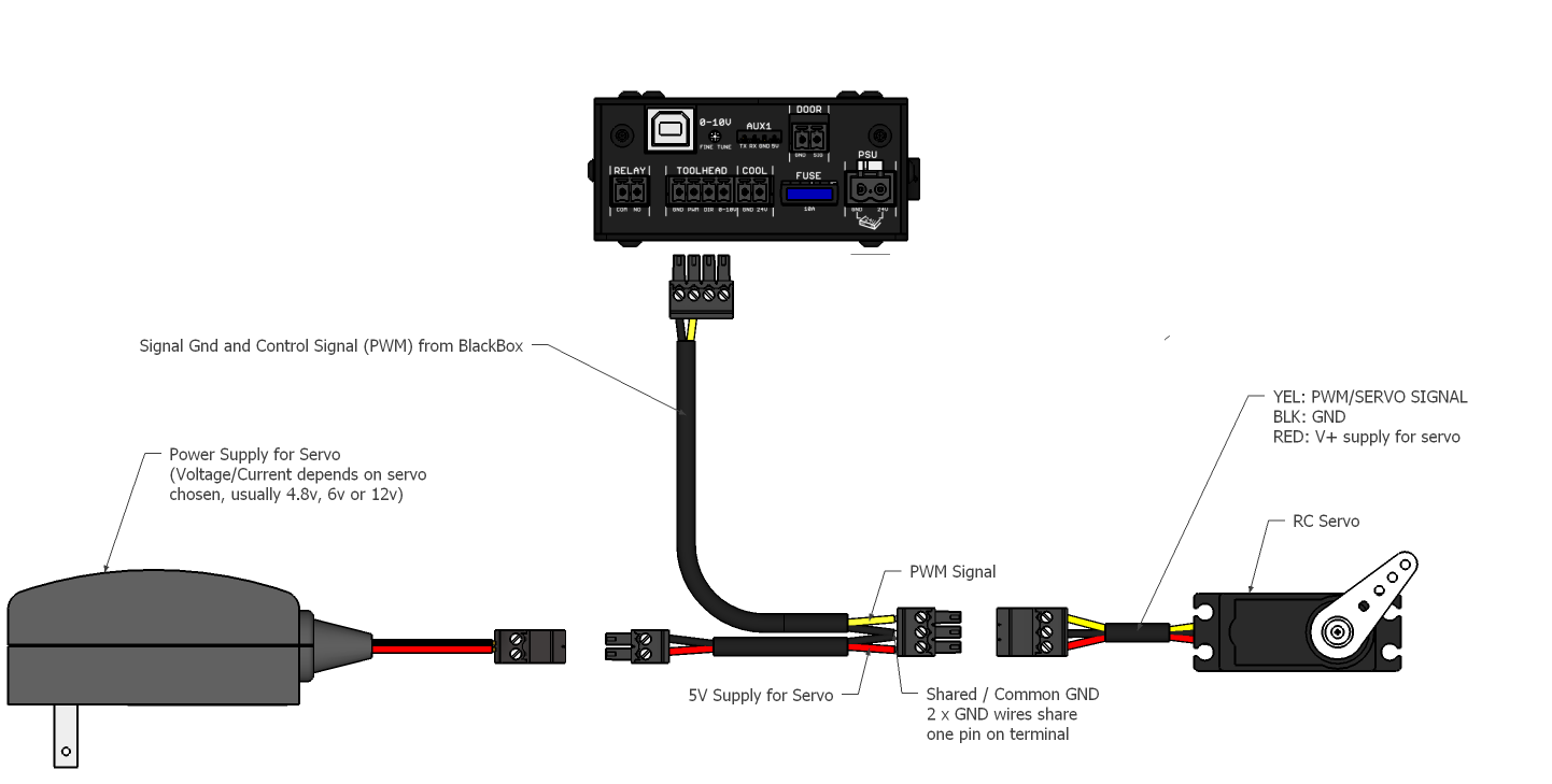

    I am just testing the new blackbox and can't get it to activate the servo. I have tried a few different servos. I hear a faint click but get no action on pen up/pen down or trying to calibrate it in OpenBuilds control. What could I be doing wrong?
    $33 is set to 50

    It works only in a very low range (13-30) on a variety of my crappy and not so crappy servos, 9g micro servos. Couldn't be a setting issue? Would it be a problem to run it just in this low range? I would prefer not for control issues

    Okay wired it with additional PSU option, plugged in with 5v and tried 6v, and the servo is still limited. After around 31, it stops responding....
    I have tried with three different servos. Each has the same problem.
  11. lizard
    lizard New
    Oct 23, 2022
    24
    I have been playing around with $30 and it seems that as I raise it the range expands but is still limited (although less so)
    Above 1800, I get action from 44-255
    At 1000, I had action from 26-133 approx
    when it was the default 255, this is when I was getting only action really between 8-33
    But it still seems strange, does this point to a complete solution? I am quite out of my depth

    Footnote 13 says:
    13 Set $33=50 (PWM frequency), $34=5, $35=5 and $36=10 to generate a "standard" PWM signal: 20ms repetition rate, 1 - 2ms pulse length range.
    If I change my settings to:
    $30 = 255
    $33 = 50
    $34 = 5
    $35 = 5
    $36 = 10
    Then I get action at all 1-255 positions. The only problem now is that the range of motion is only 90 degrees. Ideas?

    I've checked the generated pulse train and the pulse widths are between 1 and 2ms as they should.
    You may decrease $34 and $35 to output a shorter pulse than 1ms at min, and increase $36 to get a longer pulse than 2ms at max.
    FYI the servo I have moves 180 degrees when $34 and $35 are set to 2 and $36 to 15 - resulting in a 0.4 - 3ms pulse witdh range.

    Pulse width is 900-2100μs, so then it would be 4.5 and 10.5 for the range I think? When I do this maybe I get 100 degrees, but also if that is normal that is okay and it will work for me, although servo specs say 180 degrees

    Okay when I use these numbers:
    I get pretty much 180 degrees. Is this okay to continuously run if my pulse width is 900-2100μs for the servo?

    I guess so, ask the servo supplier or manufacturer if in doubt.
    > sorry, most of this is gibberish to me
    $33 = 50Hz = 20ms (1/50s) repetion rate, $34-$36 are percentages of this.
