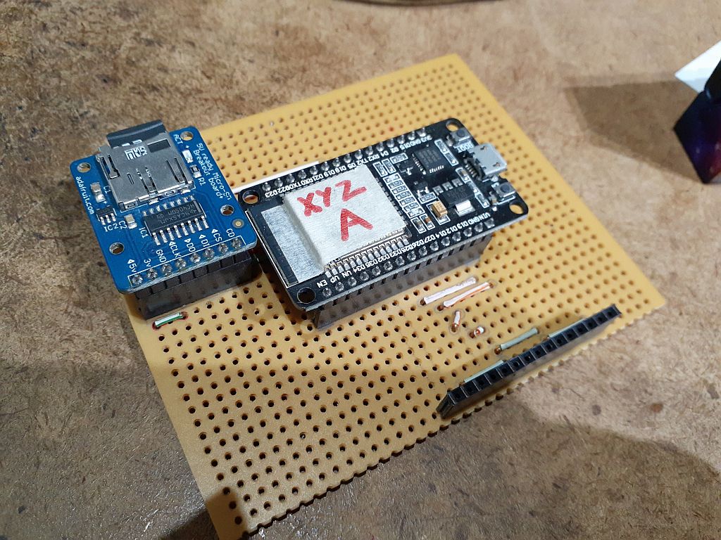

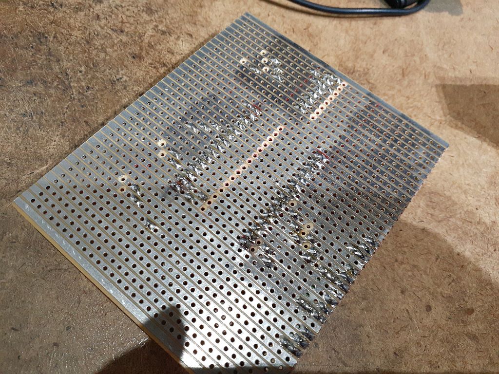

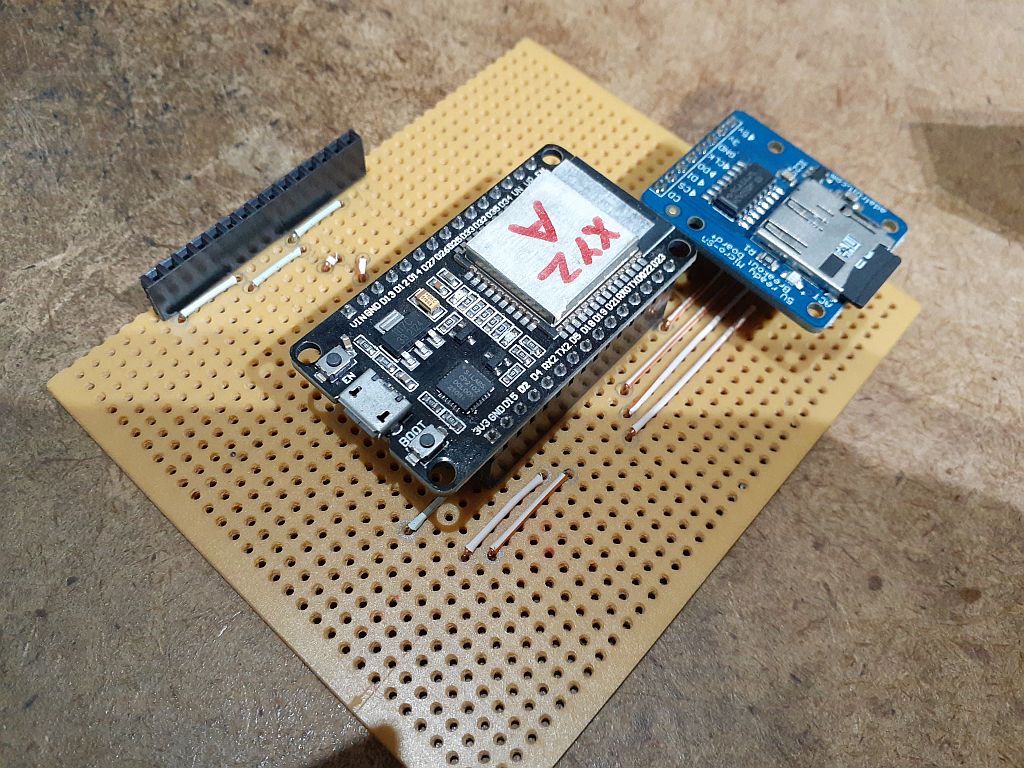

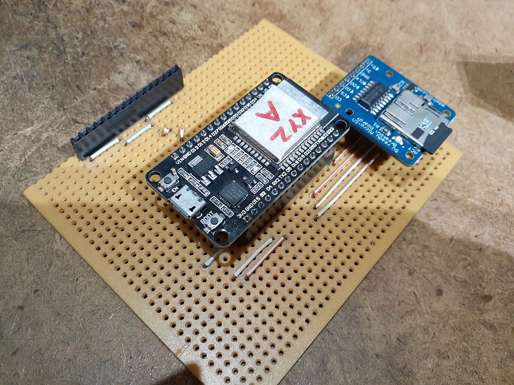

  24. David the swarfer
    3,601
    1,974
    I would buy an ESP32 devkit board, program it, and wire it directly to the existing drivers and keep both those drivers and the existing power supply.
    If you use the same pinouts as the Blackbox (defined for the ESP32) it makes wiring quite easy and reproducable.
    https://www.aliexpress.com/item/1005001648850998.html?_t=pvid:a0b606e5-f735-4f8c-a291-d58e433c1918
  25. Andy Middleton
    Apr 14, 2015
    32
    Hi David,
    I must first admit that I wouldn't know where to start with that! I'm proficient with hardware, and understand enough software to be able to configure an existing FW (Marlin, RepRapPro, Grbl) to the setup I am using, but wouldn't know how to program an ESP32 or wire it to the existing drivers! I understand (somewhat!) how to assign pinouts (but did not know the BB had an available sketch where this info was available!), but going from there to using that info to wire up a new system, not sure... (maybe I could with time and investigation!)
    I understand enough to be able to take the PCB signal pinouts for STEP & DIR and wire them to the corresponding input pins on the external driver, so if this should work with BBx32, then would probably have enough confidence to go ahead with buying BBx32, & Interface keypad (+ XYZ probe), but 500$ + shipping to EU has to be a sure thing that it will work (even if it is not completely conventional way of working for the machine I wish to convert) ;-)
    PD FWIW I have here an ESP32, although the board layout is a little different from the photo on Aliexpress, I bought it for an Arduino project a couple of years ago, but never really took advantage of all it can do over a regular Arduino Nano, for example... would be interesting to follow up on what you say, although I feel a gap in my knowledge would have to be filled before I could even try
    Cheers!
    Andy
  26. David the swarfer
    3,601
    1,974
    lets keep this simple, the BBx32 will run your machine, but because it cannot supply 7amps (and since your drivers are much bigger I would expect the psu voltage to be 36 or 48v, BB only does 24v) your machine will not be able to move as fast as it could with the current drivers, nor cut as deep and so on, it will work but will be limited compared to what it could do.
    since you are in europe you may have a local supplier of grblHAL control boards
    look through GitHub - grblHAL/Controllers: List of controllers supported by grblHAL
    maybe this one 32bit GRBL 4-Axis USB CNC Motion Controller
    arduino experience is all you need, programming an ESP32 is pretty much the same thing except we have
    an online compiler for grblHAL that will produce the binaries we need and we have a flashing tool that can upload to any ESP32 board.
    Here is the one I built (since replaced by a real X32)
    in the picture above, the female header along the near edge is where the motor drivers connect , in order Y2,Z,Y1,X
    the processor is labelled XYZA because this one was programmed for that, and I had another one programmed for XYYZ so I could just plug swap them for testing.
