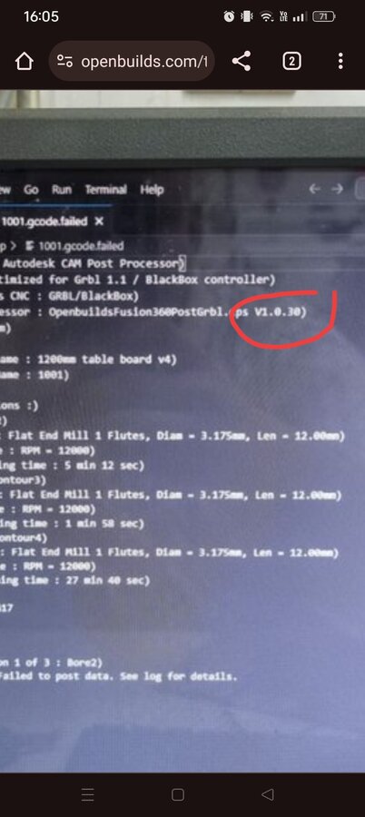

    Hi,
    The latest Fusion 360 update is giving error while using the openbuilds post processor. I am sharing the error log shown while trying to run the nc code generated by the post processor. WhatsApp Image 2024-04-13 at 5.27.59 PM-2.jpeg WhatsApp Image 2024-04-13 at 5.27.59 PM.jpeg
  25. Peter Van Der Walt
    Builder Resident Builder
    15,700
    4,510
  26. Rakesh
    Rakesh New
    Dec 17, 2013
