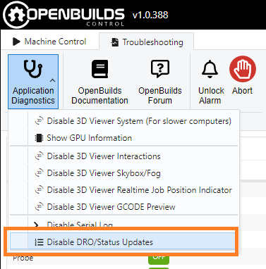

    Hello, I have a problem with a blackbox x4
    on the axes (X,Y,Z) where the position should be marked. I get disabled.
  16. Peter Van Der Walt
    Builder Resident Builder
    15,699
    4,511
    #256 Peter Van Der Walt, Jan 21, 2025
  17. CIMECH
    CIMECH New
    Jan 7, 2025
    Yes, I have an old version,
    I had to enter a new firmware
    and the new versions of openbuilds control do not have the option to update the firmware of a black box x4, it only gives you the option to change the firmware of a black box x32 and the interface
    and thank you very much for helping me with the problem
