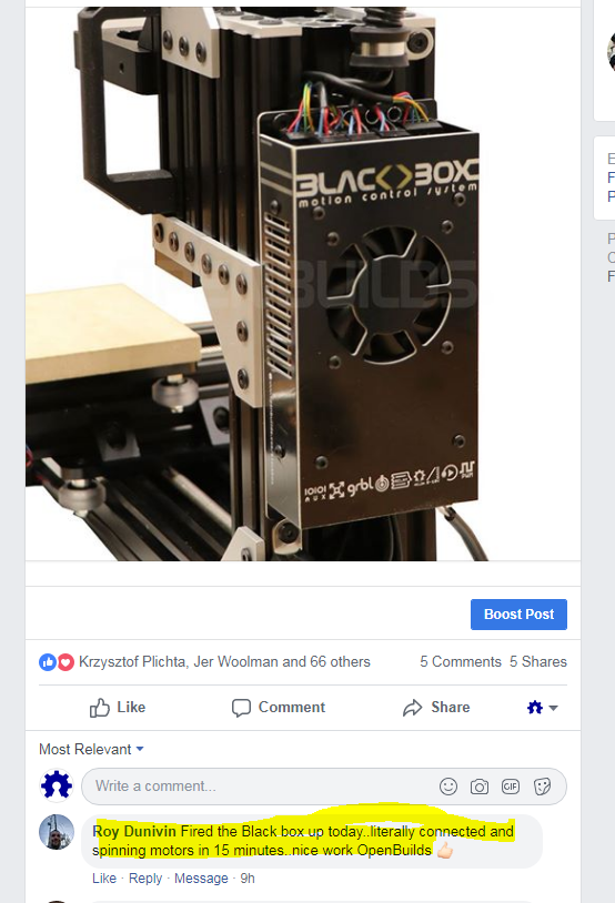

    I've been keeping watch on the forum, i think yours might be first to run :)
    Exciting!
  14. Chillimonster
    Chillimonster Well-Known
    May 6, 2015
    153
    81
    All down to getting time this weekend. :)
  15. Peter Van Der Walt
    15,699
    4,499
    (; so the title is still up for grabs (;
    (You only win my respect - but cant wait to see who is the first customer to run theirs hehe)
    Oh, and i LOVE the photo!
    Chillimonster likes this.

  17. Chillimonster
    May 6, 2015
    153
    81
    I am in the workshop tomorrow night from the look of it so will look at getting it wired in then.
    Need to figure out setting the current pots for the steppers.
    I have the high torque 23’s so can safely put 3A into them but without any sort of reference it’ll be a bit of guesswork.
    At ‘full volume’ what will the controller be putting out? As I might start at that and dial it back slightly. :)
