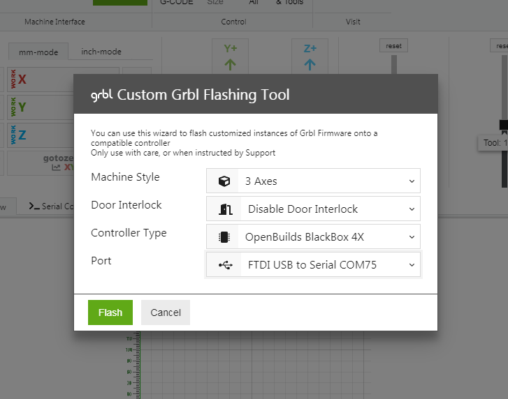

    I am having the same problem. Won't connect.
  8. Peter Van Der Walt
    15,627
    4,460
    Follow the advise above, step by step, and advise.
    Disconnect everything
    Just plug in USB
    Make sure you have FTDI Drivers installed

  10. Peter Van Der Walt
    15,627
    4,460
    Thanks for the screenshot but no mention of the rest?
    - Wiring mistakes can prevent the board from booting properly
    - incorrect FTDI Drivers can cause USB issues: Virtual COM Port Drivers

    I tried all of that. Tried a different computer as well. Same issue.

    Have you tried reflashing from Tools and Wizards -> Grbl Flashing on the toolbar at the top?
  13. Sully3535
    Sully3535 New
    May 30, 2019
    25
    Yes. I can see a red light on the controller flash when I do that. But after that still no connection.

    Does it succeed or fail (on the Serial terminal)
    :) The more details the quicker we can get to the bottom of it.

    I don't know what that means. It was working fine until the fan quit. I have made no changes to the controller or my computer.

    Flash failed
