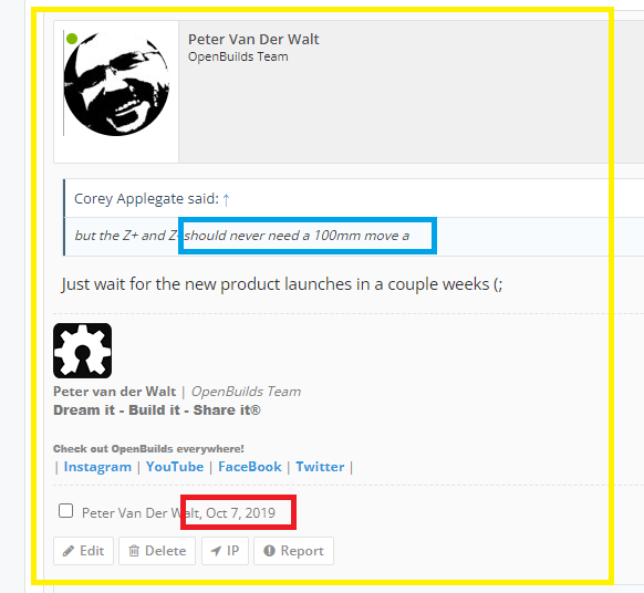

    Randomly saw this. Is new product launch something I should be getting excited about and is it a secret?
  7. Peter Van Der Walt
    15,674
    4,483
    Seeing as the post you are replying to dates back to 2019, and from the context (about Z axis move lengths) I guess we can safely assume that those launches already happened.
    Both the OpenBuilds LEAD CNC Machine 1515 (60" x 60") and High Z Mod for Lead 1010 CNC has Z axes over 100mm
    Screenshot of the old conversation for reference:
  8. SeanD
    SeanD Well-Known
    Mar 23, 2019
    207
    65
    Omg sorry, I just read new product and the rest no longer was visible to me :)
