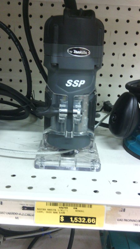

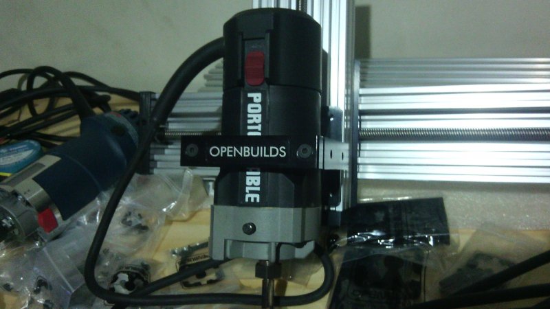

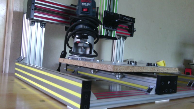

    IMG_20150830_202107.jpg IMG_20150806_124808.jpg View attachment 10803
    You can use Bosh like the pictures, Dewalt and Porter Cable even Makita you only need to check the spindle diameter for the OB router mount, It's an awesome machine :)
    Ps. Double check if the router or spindle have speed control or variable speed, and use good quality router bits that's also very important not only the spindle IMG_20150905_120812.jpg

    What currency is that Makita?
