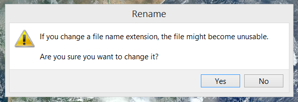

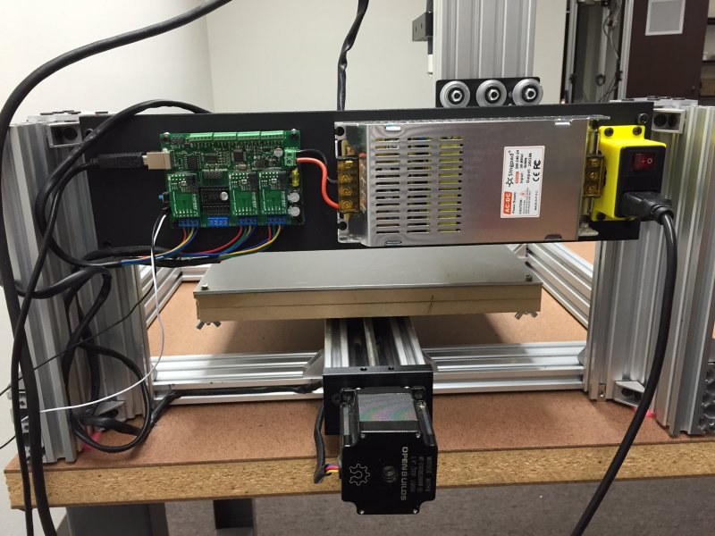

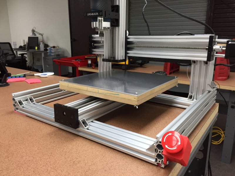

    Hi Guys, first time poster showing off my progress.
    Finally found some time to work on the C-beam build again. It appears ready to cut some aluminum, I think. Did an acrylic cut and came out really nice.
    I did some quick test a few weeks ago and has since tweaked the machine and runs pretty smooth now.
    I placed the controller and 24V PS on a plank at the rear. It will have an acrylic cover eventually with just a hole for the IEC cable and everything covered. I did a quick design and 3D printed the E-stop and IEC housing.
    I will try to cut something aluminum by tomorrow, some brackets maybe for a 3D printer Im building.

    Well done @royco :thumbsup: great looking machine build!
    Really like the back panel you have there its a great idea and it really makes it look nice and neat.
    Thank you for sharing.

    This is not a problem just hit yes
