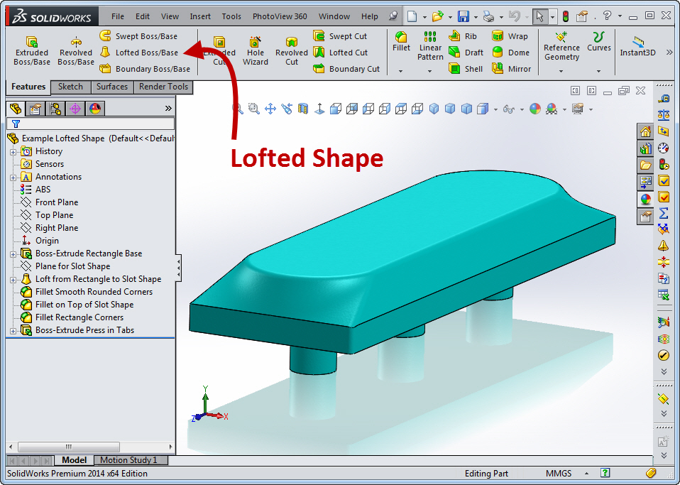

    I added the STL files to GrabCAD.com for the 3D-Printed 'press-in' End Caps I made for Extruded Aluminum that came with my OpenBuilds - C-Beam Machine - Plate Maker ... You can download them for free at: GrabCAD - CAD library ... I have printed them in PLA and ABS filament ... They are a tight fit so they will not easily come off once pressed-in; however if needed you can sand off the sides of the areas that fit inside the extruded aluminum to make them easier to press-in and take off.
    Let me know if you have any ideas for 3D-Printed extras to add to the C-Beam machine build? ...

    3D-Printed End Cap STL files for pressing in the ends of the Extruded Aluminum that came with my C-Beam Machine CNC Kit
    ... GrabCAD - CAD library :)
